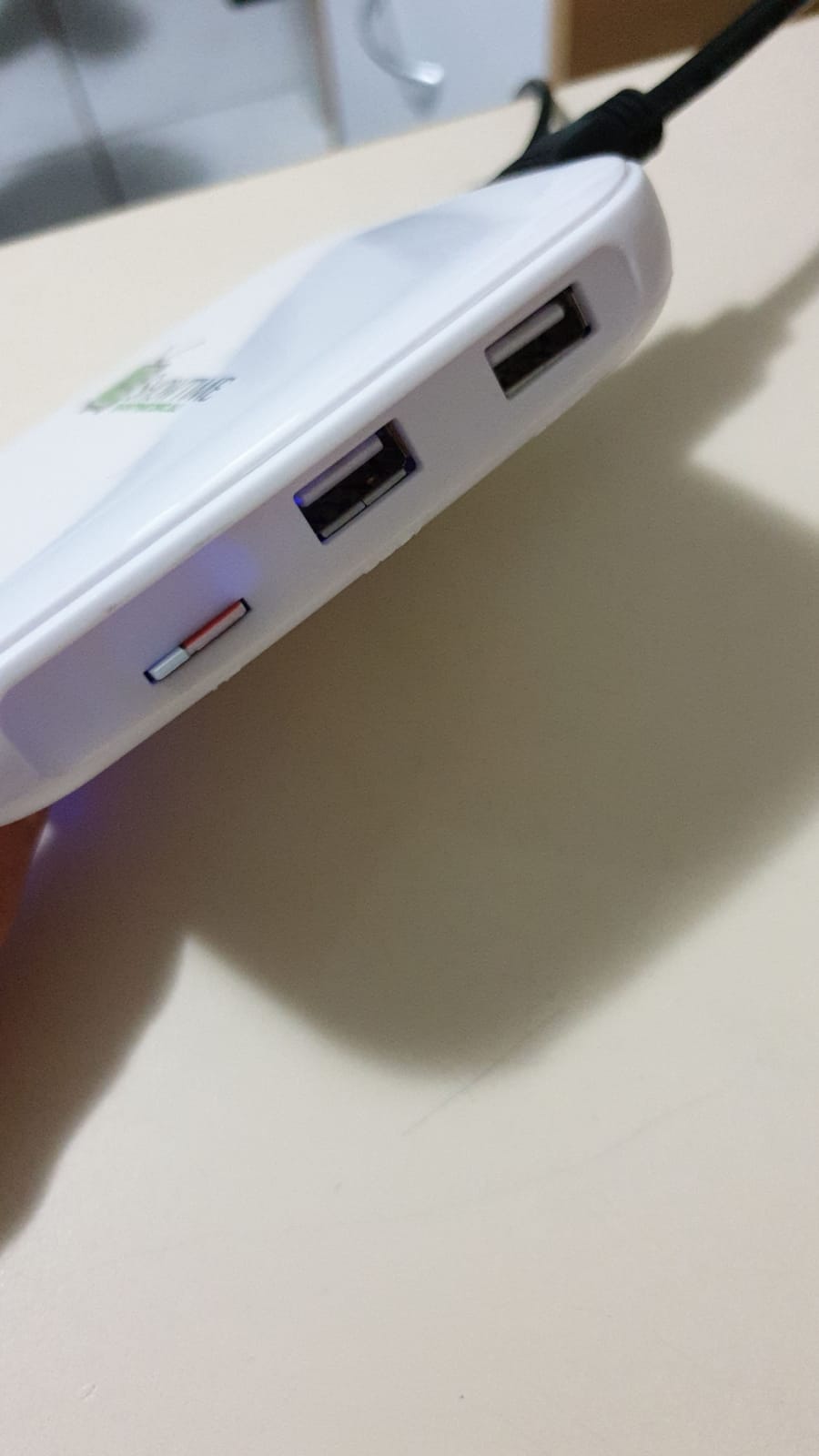

  • V88mars but it won't boot (only red led).
    Please double check, not to use v88marsII, but v88mars image - red led indicates that the kernel has been loaded (as it gets turned on by the kernel)
    I'm not using uhs cards because I've discovered that my sd controller does not support uhs at all
    Hhhm, the card showed on your pics is a UHS1-Card.
  • Quote
    you are right, sorry.
    However my aim is to share with other peoples my tests and some coding in order to help development.. But thanks to your hard works, my box with some tricks works even with uhs1 (I've also rebuilt kernel and installed Slackware for fun). Discover what exactly was wrong with your images or what model exactly I've buyed is only for that. If you think are useless I stop spaming ;)
