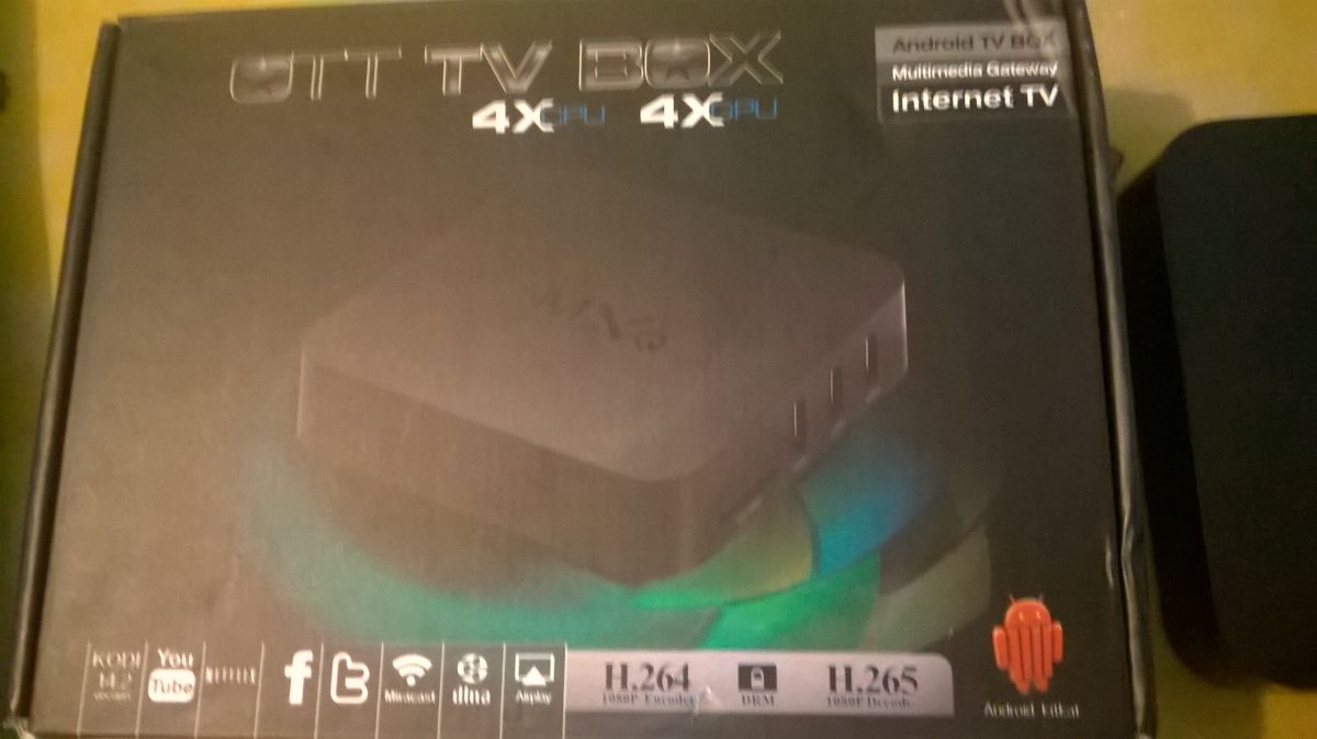

  • hi webman, I have the same tv box as you, it got bricked and I can't find any solution. When I use usb tool it goes to 2% or 5% and stucks, I've read in forums that happens because the ROM image isn't the right one. ¿which version of it did you install to recover? and which version of libreelec could I try? I need it to be charged via USB because the SD card method doesn't wokr (tv says "no signal")
    thank you!
    Device Detail
    MXQ S805 m201c
    Board Model : MXQ-S805_D08 Ver:1.0 DATE:151221
