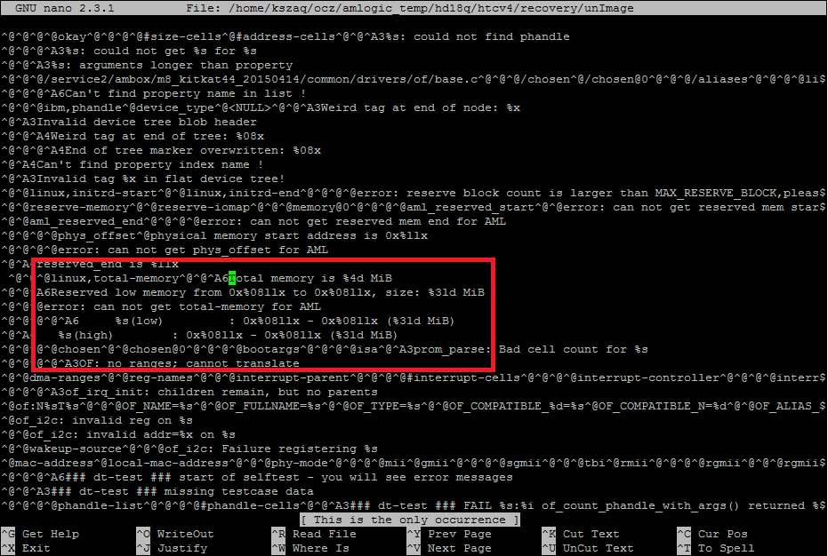

kszaq,
I have the same thing with my all balck mxq, it freezes when trying to play anything. I have the same configuration as Kiwi_man82 has.fanni sent me a box with the V3_1 board and I was able to play with it a little. I was also able to reproduce the issue and I think I have a fix!
The bad news about that board is that it has 512MB of physical RAM.
Here's screenshot from unpacked kernel proving that they are faking RAM amount in kernel log (They also fake RAM amount in free command in Android):

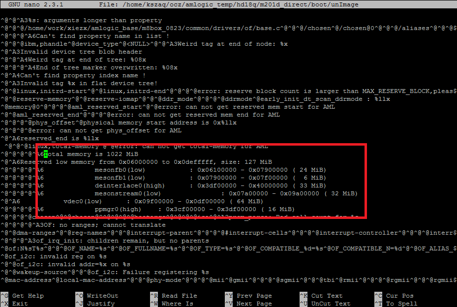

And here's a screenshot from kernel from other box that prints real RAM amount:
At first I thought they are somehow initializing the second RAM chip later but now I am almost 100% sure that half of the RAM is a fake.
