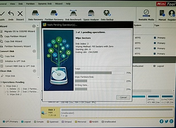

If on Windows, try "Minitool Partition Wizard Free" (or similar) and run full surface test.
I'm trying this this morning. I couldn't find the option to run a full surface test, so I simply am trying to wipe the disk. I'll report back.

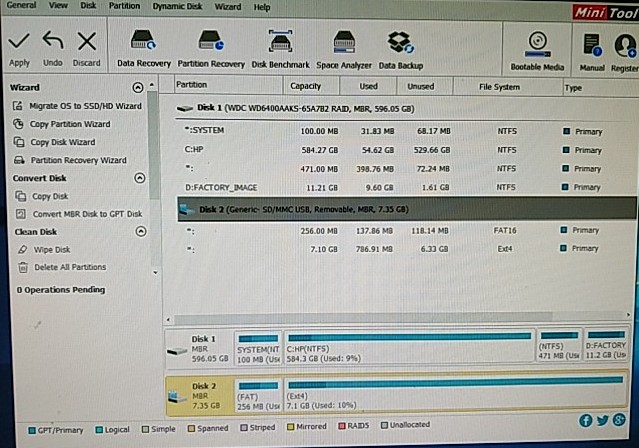

As you can see in the below pic, Windows is not recognizing the SD card, but Mini tool is and shows as wipe, but I guess it simply needs to be formatted, but Windows won't allow.

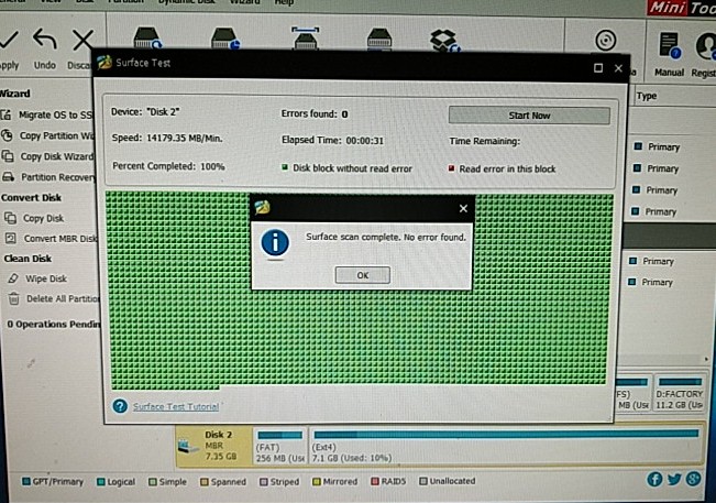

And I found the surface test which I did after I had wiped the disk, see below no errors found.
Have you tried formatting in mini tool after the wipe?
Even a good card won't work after mtpw has wiped it - until it's reformatted.

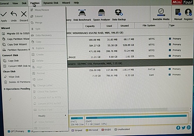

Trogggy, I've looked into formatting with MTP, but when I highlight the disc 2 SD card, the format in the partition tab is greyed out. Is there something else I need to do first. Do I need to rebuild the partition, if you can tell exactly what is needed, I'll give it a go., cheers
I just tried an old 512MB sd card with MPTW and it looks as though it's behaved differently to what you see. When I wiped the whole card all partitions were deleted, and right clicking on the unallocated space gave me an option to create new ones. If it were me I'd now be trying g-parted.

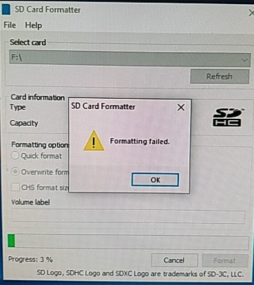

i tried formatting using EaseUS and comes up with error and partially done.
