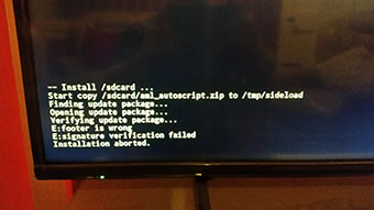

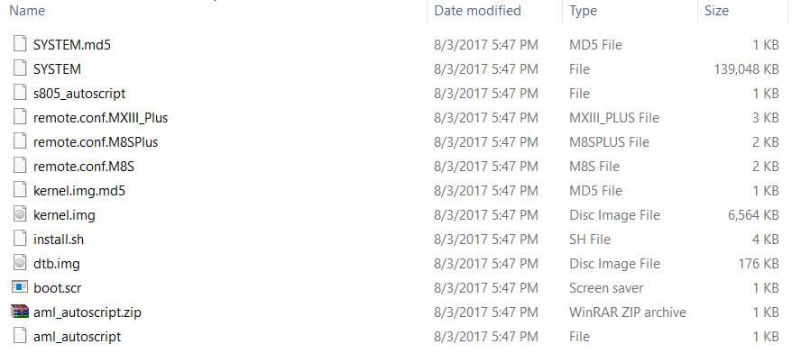

  • I was already to sleep yesterday, so I didn't see your post. You have to put them all on the root of the sd-card and then do the toothpick method. If everything is alright you should see the picture of the droid with a spinning wheel in his body. If you are still on TWRP it will not work. Then you have to install the recovery.img first from TWRP (if I remember correctly) and then do the toothpick method again.
    If you are not sure you can do following command in a linux terminal: cat factory_update_param.aml
    It will show you the text inside of the file. With a little imagination, you can read what files the update needs and what it will do.
    You can do the same for the aml_autscript: cat aml_autoscript (make sure you cd to the folder where the files are located).

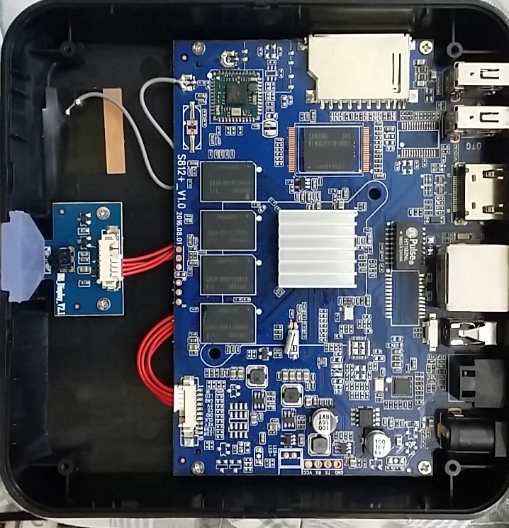

  • Hi,balbes150,
    I have a box hardware is S812, 1G ram, 4G Nand, 100M lan, RTL8189 WIFI, I tried the ROM you provide in the thread, but it can not boot up, I burned it in TF card, but the sytem reboot all the time, evenI replaced the dtb file from original Android ROM.
    Could you it possible to compile a ROM if I provide the dtb file?
    Or I have to build it by myself according to your source code. thanks!

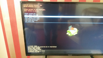

  • Here are the steps:
    1. Download drieschels build libreelec-s802.s82.arm-8.0.0-2-alpha-devel.zip
    2. Unpack the files and put them in the root directory of your SD card / USB drive (don't burn them with an image tool !!!!)
    3. Start the box in recovery mode (toothpick) with the inserted SD card / USB drive
    4. Choose Wipe/factory reset, and then Update from EXT. Choose your SD card / USB drive and the zip file which is on it
    5. LibreElec should be installed on your device now
    6. Start the SAMBA service and put this build in the update folder (\\libreelec\update) and reboot Loading site please wait... (dont know if it is necessary to perform this update but I did so)
    7. Now you're on LibreElec 8.2.3
    8. Download the "LibreElec-S812.arm-18.0_20180601-LAN_100.tar" file and put it into your update folder and reboot Nothing found — Yandex.Disk
    9. Now youre on LibreElec 9.0
    10. Be happy

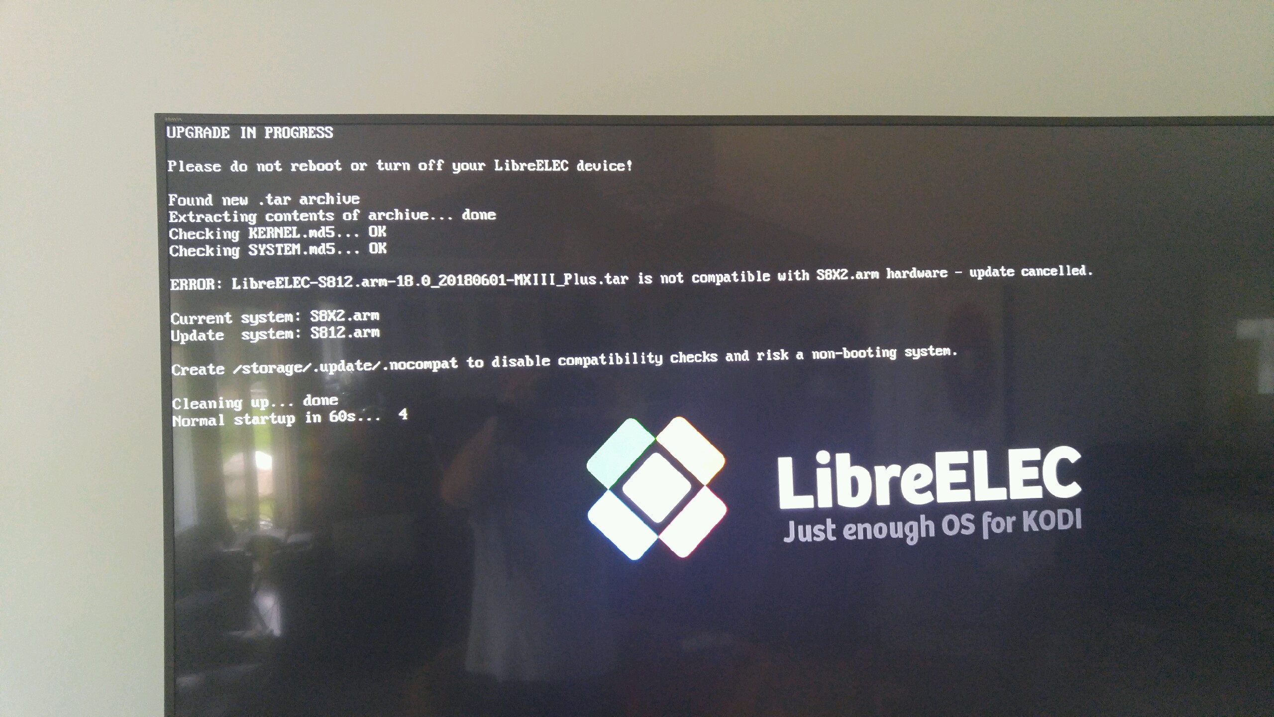

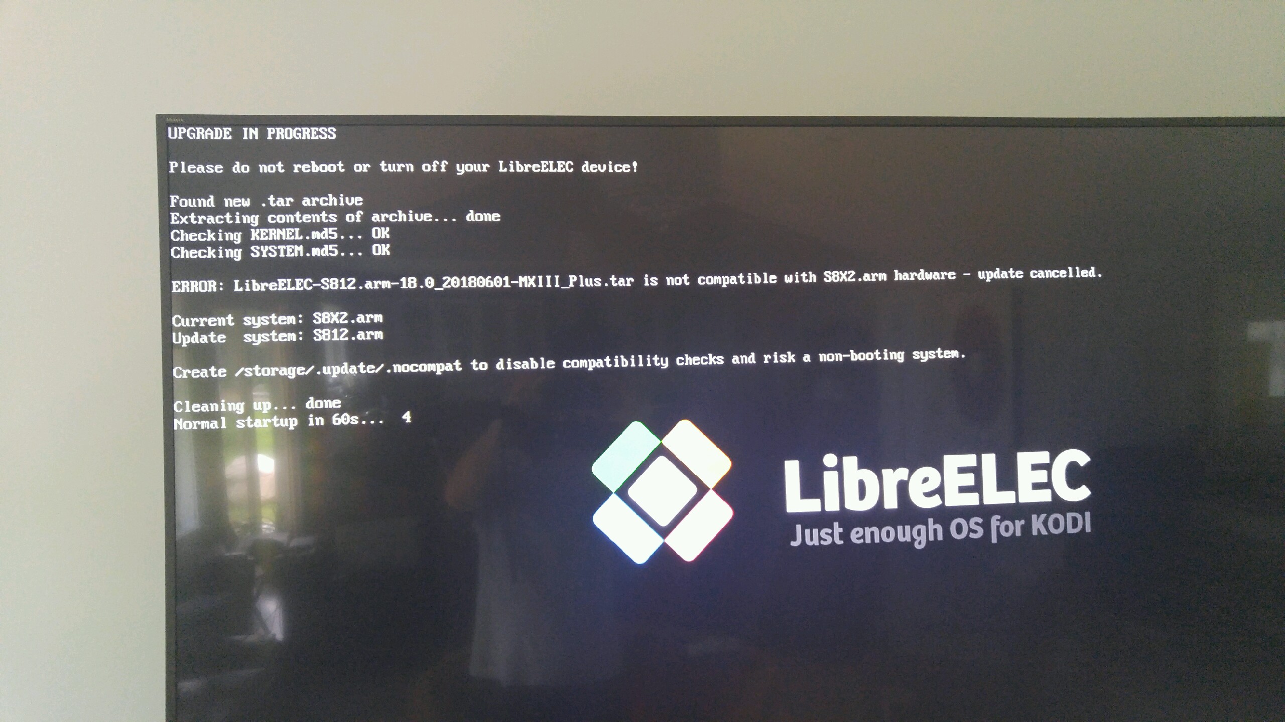

  • Thanks for the nice step by step guide. I did this a little differently. I'm running off an SD card and worked the update that way. As I was already on demetris's 8.2.3 build for the MXIII Plus I copied the balbes150 update 0601 for the MXIII Plus into the update folder and rebooted.
    Some time ago Ii tried to update an older demetris build with an older balbes150 build and I got an error. I don't remember the error then, but I had to rebuild everything over again. I also got an error when I tried to update demetris 8.2.3 with Leia 18.0. I attached a picture showing the error.
    Luckily the box booted back to 8.2.3.
    I'm not sure why the error occurred, as the MXIII Plus is what I have and both the demetris and balbes150 MXIII plus builds are what I am working with. I originally thought it was something different about the builds, but since you updated demetris 8.2.3 with balbes150's Leia build I'm not so sure that is the problem. The Beelink MXIII Plus specs - 2g/8g, gigabyte LAN
    Beelink MXIII Plus components-1.txt
    I'm looking for some help with this problem and appreciate any comments/corrective actions. Thanks
    MXIII-G, M8 and Beeklink MXIII Plus LE 8.2.2 - Demetris, Mecool M8S Pro+/Abox A1, Abox A1 Max Coreelec 9.0.2. Thanks to all.
    Edited 2 times, last by doggyofone: I had tried this before with a demetris build running on the SD and then updating with a balbes150 image. It failed then and again with this Leia build. ().
  • doggyofone
    I'm sorry to hear that. Did you try to to create the file and disable the compatibility check? This message didn't appear during my upgrade process. But the S802 and the S812 are very similar so you could give this a try. Did you install the 8.2.3 from my link? There is a build for the MXIII Plus from Demetris. Maybe this could solve your problem.
    Orbsmart S82 LibreElec by balbes150
  • doggyofone
    I already had Demitris's 8.2.3 on the SD card and that is what I tried to boot with. This time I will add the .nocompat.zip that we normally need to boot a demetris build.
    Thanks guys for your help.
    Update - I reloaded a formatted SD card with demetris's 8.2.2 for MXIII_plus and a .nocompat.zip that I have been using for his builds and installed Libreelec successfully via toothpick. I gave the box a few minutes to update and then tried installing the balbes150 June 1 tar update for the MXIII_plus a couple different ways:
    - In Windows I opened the box IP and added balbes150's June 1 Leia for MXIII_plus and a .nocompat.zip (used for installing demetris builds). I toothpicked the SD card. The install failed as before, per the picture in post 781. Eventually the box rebooted back into 8.2.2.
    - The second attempt I opened the update folder and copied balbes150's June 1 Leia for MXIII_plus. I then extracted the .nocompat.zip I use for demetris's builds and copied that file into the update folder. I then booted the box, Libreelec installed successfully this time, rebooted and then got stuck on the boot/Libreelec splash screen. I restarted the box and it got stuck on the same splash screen again.
    I'm not sure what to try next or if I am following the right steps. Should the .nocompat.zip be installed prior to running balbes's image?
    I have already written to you many times that Demetris's multi-boot system is incompatible with my images. Therefore, all your "hybrid" experiments do not give results. You cannot upgrade Demetris image SD \ USB to my version and Vice versa, its images do not have the necessary s805_autoscript scripts, without which multi-start does not work. I do not understand why you ask questions and ask for step by step instructions, if you still do it on your own (not following the step instructions). If you want to get the result - follow the instructions exactly. Note that those users who exactly perform the steps get the working system or to SD\USB, or eMMC.

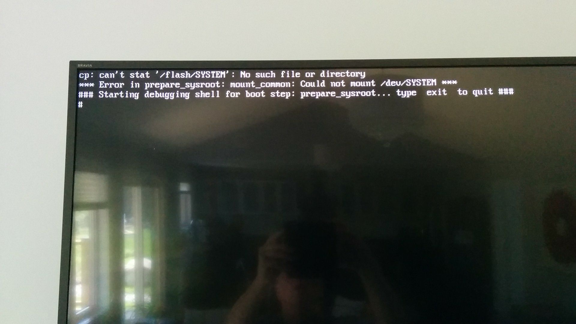

  • I have followed your instructions per post 771 and post #766 and reinstalled the stock firmware. I tried booting from your builds from the stock firmware with no success, April 2017, June 2017 and your 8.2.3 build. If one worked I was hoping to update to Leia. None would boot.
    As a last resort I tried following An's instructions, but the step 6 image link is for a demetris build. I tried anyways with demetris's 8.2.2 build but had little success. Then I tried with a nocompat.zip extracted to the sd card with your Leia 6/1/2018 build. I toothpick booted the image and it installed but got stuck on the Libreelec screen. This is the closest I have been to installing your build.
    I have tried again with your 6/1/2018 build on a fresh install of the original firmware to toothpick boot the image and nothing happened. I formatted the card and booted demetris's 8.2.2 build and it loaded successfully first try.
    So my question is, how do I boot your Leia build? Which steps "Note that those users who exactly perform the steps"?
