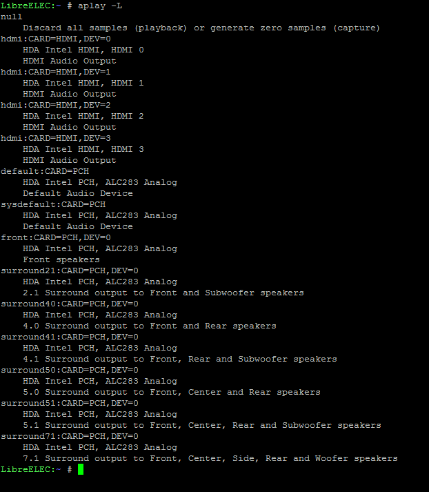

  • get system tools addon from libreelec repo
    open and type aplay -l
    shows list of your output devices...
    make note of the one that you are going to use
    nano /storage/.kodi/browser_addon/chrome/bin/chrome_start
    there is a alsa section and where it says:
    chrome_OPTS="$chrome_OPTS --alsa-output-device=$ALSA_DEVICE"
    chrome_OPTS="$chrome_OPTS --alsa-output-device=plughw:x,y"
    and add the device and id in it
    save and exit
    make sure you have the keep sound alive option OFF
    and it should work,,,
    if not working at first try, go through the entries for your output device one by one...shouldn't be to many
