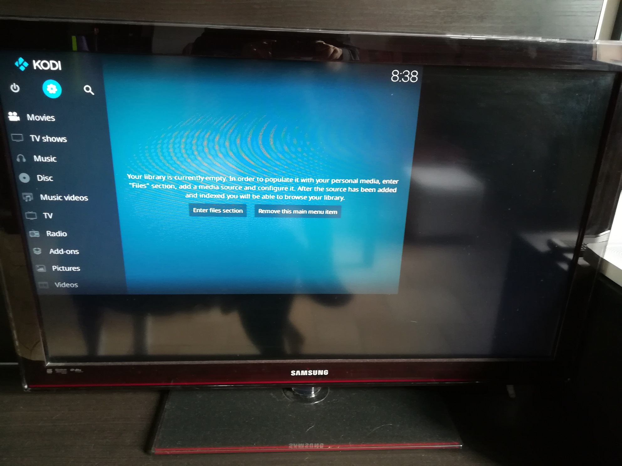

    I installed libreelec on a usb pen, I tried to boot on a notebook which is connected to a 42-inch samsung tv with a vga cable.
    The system starts without problems, only I can not see it in full screen on the TV.

    Kodi only supports clone mode for multiple monitors, so if your notebook only has 1366x768 for example, then that will be the leading screen resolution. Perhaps you can somehow turn off your notebook screen and make the TV the primary display.

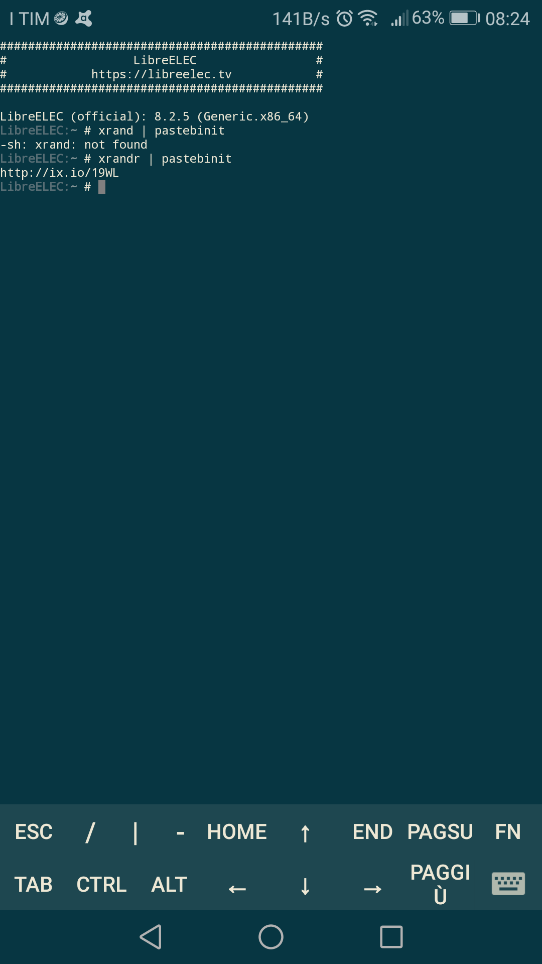

  • i tried the command xrandr | pastebinit, in attachment the screenshot ,
    the monitor set it isn't correct because the tv is 40'', how can i do to set it?
    and how can i do to set it at the boot?
    thks

    Kodi evaluates what to use at start, so turning the display off after Kodi starts won't result in Kodi dynamically reconfiguring itself. Stop Kodi, run the command, start Kodi again and it should only detect the active panel. If that works we can script it at startup.
