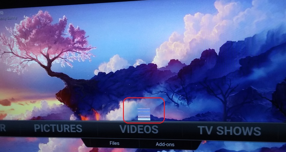

    Problems to find hdmi signal after reboot . wen i reboot 10 time or more the tv is working . but its working fine on simple pc tablet bit not on tv
    External Content pastebin.com
