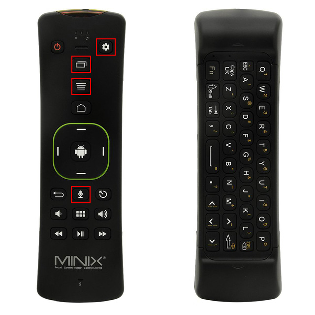

  • Could other owners please join in. I'm sure many people here own Minix NEO U9-H and many of them own A3 remote.
    Could those owners please tell us what is your experience with the remote? Does the SETTINGS button register under Keymap Editor addon?

    The problem is that as I said I created an hwdb file and it is still not working for my other remote. I will receive a new A3 a little later and will try it and report here.
  • I received my new A3 and as soon as I created an hwdb file, it started to work. It seems something is wrong with my other remote and it's not standard or something.
  • Question, the file I made
    evdev:input:b0003v0C40p7A1Ce0110*
     KEYBOARD_KEY_070070=171        # settings
     KEYBOARD_KEY_0700bb=23         # tabs #I (Info)
     KEYBOARD_KEY_070065=46         # menu #C
     KEYBOARD_KEY_0c0224=esc        # back
     KEYBOARD_KEY_070073=113        # mic #MUTE
     KEYBOARD_KEY_07003a=50         # apps #M Player controls (OSD)
     KEYBOARD_KEY_0c00b6=168        #<< REWIND
     KEYBOARD_KEY_0c00b5=208        #>> FORWARD
    for the line
    I have to put "esc". If I put the number "1" the line doesn't work. Why is that? "1" is the same code as "esc" and it does the same thing. For some reason all the other 7 codes I put work, except code "1"!
