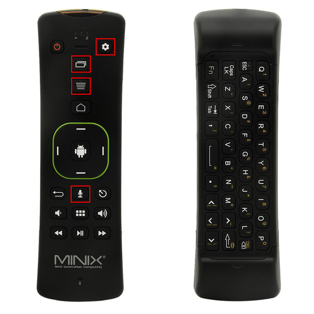

    When it was working I remember that it was exactly those keys that fxffrank posted not working. I remember it was not just a question of remapping. I used the keymap Editor Addon and did not receive any codes from those keys. I don't understand how you receive codes.
    I have no idea what to do next.
    My bad, I meant partially work and buttons like "Settings", "Tasks", "Mic" still won't register in keymap Editor Addon like you mentioned.
    Minix NEO U9-H with Minix NEO A3 on LibreELEC-S912.arm-8.2.4.1, buttons highlighted below don't work by default.
    I had to remap some of the buttons to make it partially work.
