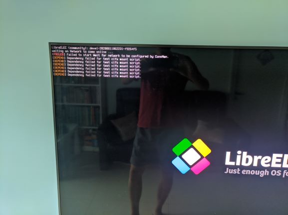

  • I have a Khadas Vim3 and I have just installed the following image:
    "LibreELEC-ARMv8.aarch64-9.80-devel-20200811062231-f9264f5-amlg12.tar"
    I have my device connected to the network via LAN but the network never comes online (see the attached image). Previous version of the software used to work though.
    I can confirm that the LAN cable is working 100% since I tested it with another device. Many thanks.

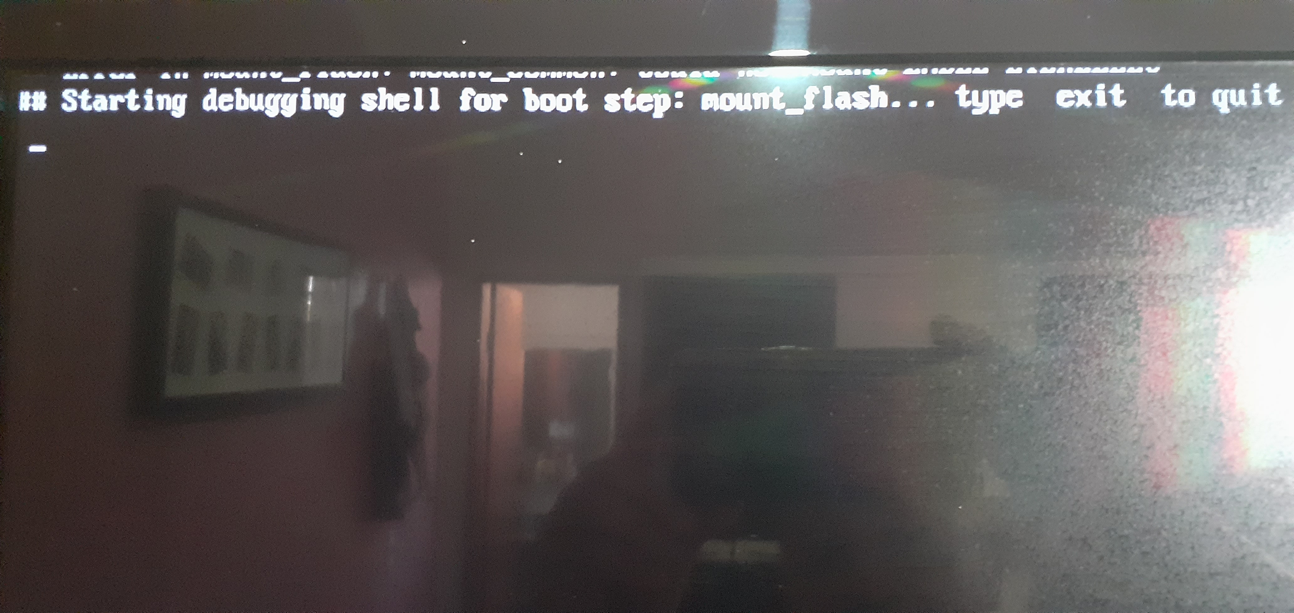

  • Edits made as mentioned above for mecool KI Pro: ok boot
    I immediately received an error, which apparently and in the usb usb ports do not work to complete the installation with usb remote.
    Can help balbes150
    LABEL LibreELEC
      LINUX /KERNEL
      FDT /dtb/amlogic/meson-gxl-s905d-p230.dtb
      APPEND boot=LABEL=LIBREELEC disk=LABEL=STORAGE quiet console=ttyAML0,115200n8 console=tty0 systemd.debug_shell=ttyAML0
    There is no dtb suitable for K1 Pro as in previous builds, I used meson-gxl-s905d-p230.dtb
