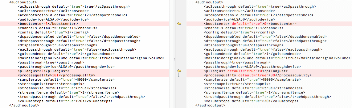

    here is my Setup: Raspberry PI3 with HiFiBerry Digi+ with optical cable to my Audio receiver.
    Until last week, I had OpenELEC 8.0.4 running on my PI and I enabled Passthrough + DTS capable Receiver.
    When I played an mkv File with DTS audio track, my receiver said: DTS
    Now I installed LibreELEC 9.0 Alpha nightly build and configered in the same way.
    Now my receiver says: Dolby Digital (seems to be a Downmixing).
    Any ideas?

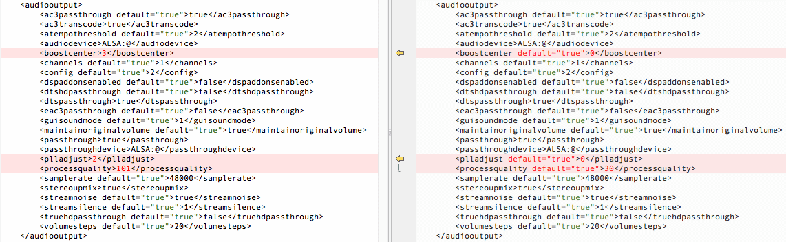

    PS: I have a full system export of all files from both systems available. I attached both guisettings.xml files to compare.
    Thank you!

  • Here is the logfile of a sample.file with DTS Sound:
    Creating audio stream (codec id: 86020, channels: 6, sample rate: 48000, no pass-through)
    why?? :(
