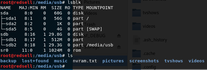

Sorry for being newbish (I am actually new to this), but how do I access LE system partition? When I plugin the MicroSD into my PC, all I see is the Storage folder. I have 2 partitions, of which one is the EFI (I presume). But when I try to explore the sdb/sdb2, all I can see is the storage. How do I access the root, and extract SYSTEM file? I know I can use SSH to extract the SYSTEM file, but I cannot replace the SYSTEM file with a new one via SSH because read-only file system won't let me.
The SYSTEM file is in /flash, but you shouldn't replace it from a running system via ssh as that'll crash your box (it's being used and if you swap it out behind LibreELEC's back things will go really crazy - I accidentally did that once). You'd have to do that without LibreELEC running, eg from a Linux live boot or Windows on a separate partition.
