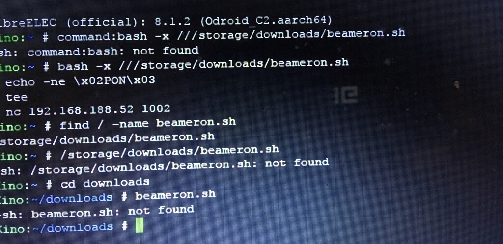

  • okay I write:"cd /storage/downloads" and I´m in the downloads folder (very good).
    I enter ls -all and there is the file:
    -rwxr-xr-x 1root root 66 Sep 28 22.25 beameron.sh
    I write script (skript) only as an example. The original name of the .sh is beameron.sh an I write it correct.
    It looks like that in LibreELEC everything is ok.
    But how can I now send the command to open the file using Cinemavision, because command:"///storage/downloads/beameron.sh" doesn´t work?
    The curious is: when I write in the Terminal "bash -x beameron.sh" the command works and Power on my Beamer, but I need a command that I run in Cinemavision. So I think the beameron.sh script isn´t the problem.

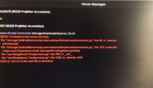

    In the jpeg you can see how the error looks like in Cinemavision:
    PS. the old .sh named beamer_On.sh and now I change to beameron.sh so don´t care about it.
