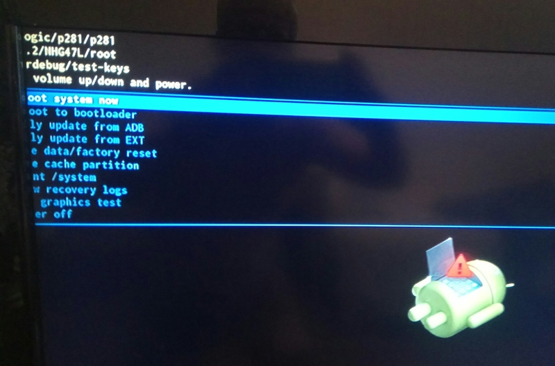

When you try to load, there is a picture like this.
Tell me what to do?

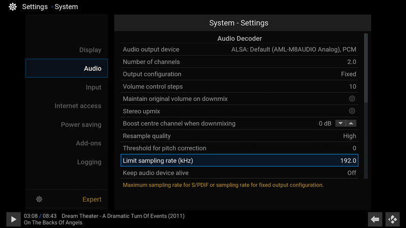

... I need to output two channels audio stream at its original bit depth and sample rate, without resampling.

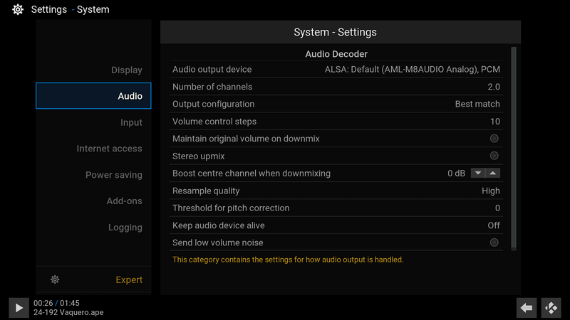

Here are the my settings to guarantee output Stereo 44-192 without resampling (bitperfect) via SPDIF TOSLINK. (pic1, pic2)

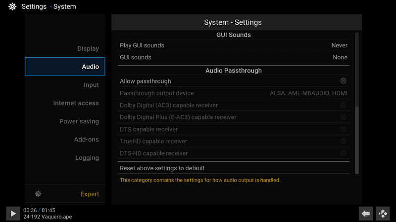

For tests it is possible to record force output in 192kHz (pic3) "Output configuration - Fixed"

I understand your concerns. But as far as I know, the SPDIF signal is supplied to the optical transmitter directly from CPU Amlogic S905(X)
On his way there is no any other chips and components.
Only one option, the manufacturer has put very ancient optical SPDIF-transmitter which can not work with a frequency of 192.

Look in the audio settings - paragraph do not remember exactly - "limit sampling rate" - maybe there you have 96 khz? In this case, set 192 (or 352, 384)
The audio files (FLAC and WAV) at 16-bit/44.1KHz, 24-bit/88.2KHz and 24-bit/96KHz are outputted correctly, without resampling. The files at 24-bit/192KHz are not played, just silence - no sound at all - and the DAC doesn't display anything.

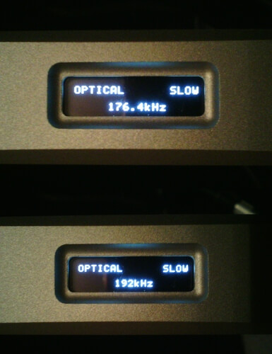

Amlogic S905, S905X great outputs 192/24 on optics SPDIF (TOSLINK), starting with version 7.0.X. (see pic.1)
My report -> [8.0.2e] LibreELEC 8.0 for S905/S905X

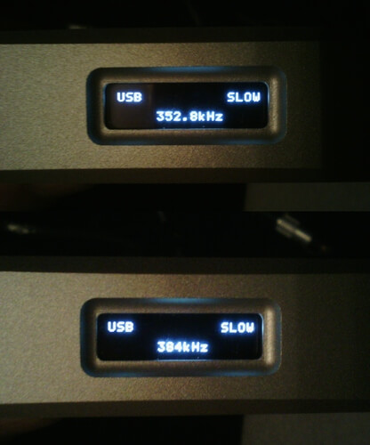

In recent releases of 8.1.x ower USB can be output to the DAC the frequency of 352.8 khz and 384khz - (see pic.2)
It works on all my players, and a few of my devices DAC.

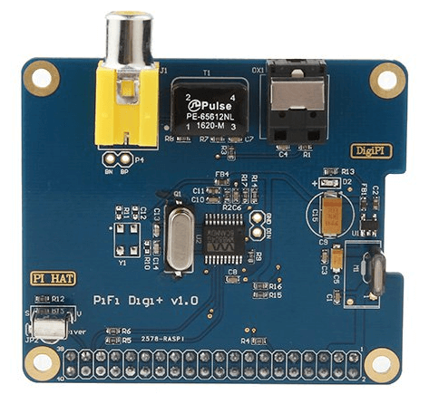

I have Raspberry Pi3 & PIFI Digi+ (this clone HIFIBerry Digi+) & Libreelec 8.1.0 (or 7.0.3)
In order for the SPDIF output to work - in the file config.txt added:
This Board have the IR sensor. for his work, in the file config.txt added:
