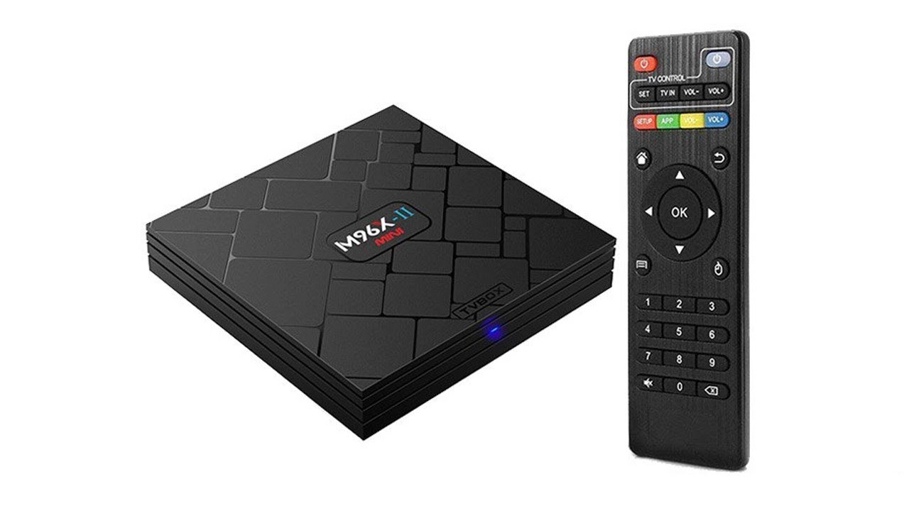

I saw your remote and it looks exactly like mine for the R-BOX Pro. replaced the config file and now I got a working remote to get through the LIbreELEC and KODI initial setup!
THanks a bunch!
edit: Apparently the power button powers my Epson projector too. LOL.
Got the remote to work.
Copy and replaced the Remote.conf file with this one:
It matches the remote that came with my R-BOX Pro so I figured I give a try and Viola. works enough to get through the setup menu.
