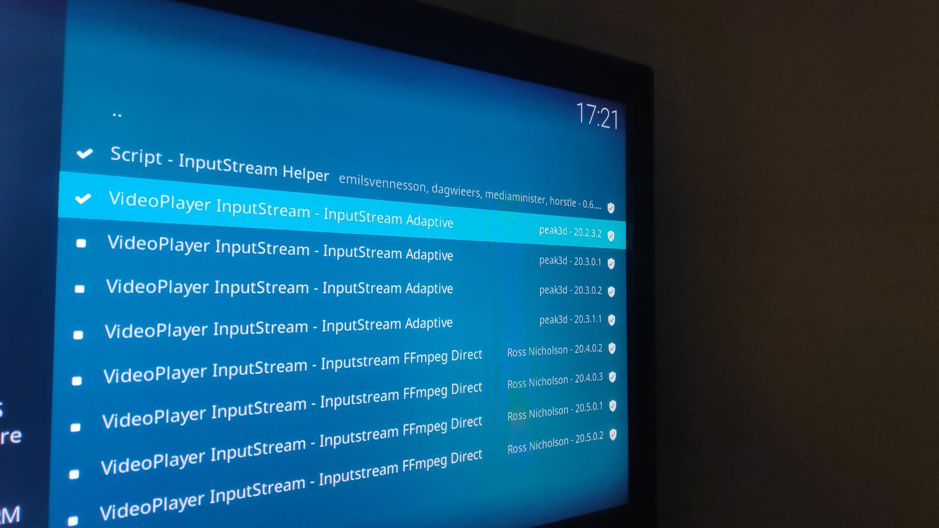

But when i check the kodi repo the latest inputstream is 20.2.3.2
And i need a later version to be able to install youtube. Does anyone ahave any tips? I've tried to download the zip file manually but it doesn't work since i get a "couldn't be satisfied" error. On the attached image you can see that i have 20.2.3.2 installed, and that is the only one i can actually install.
