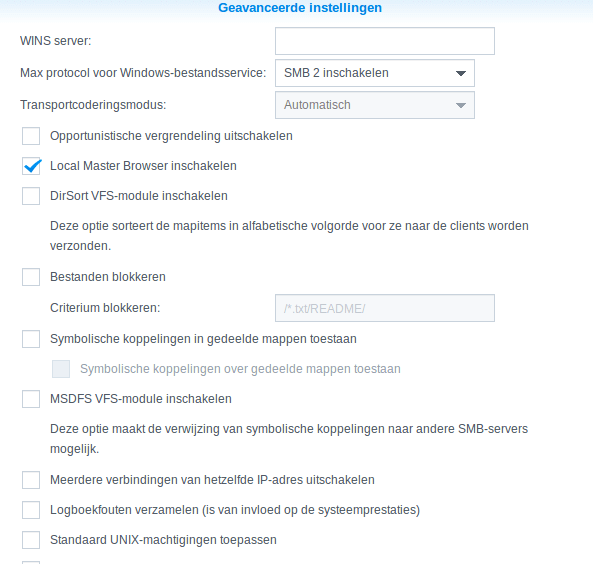

    My NUC has also the Samba Share problem, also whit a Synology NAS.
    I see the movie in the libery but when a push play the dont play..
    Lates updates dont work .
  • Kodi settings > services > smb client > set max client protocol version to SMB2 .. it will prompt to reboot. This should prevent Kodi attempting (and it looks like failing) to autonegotiate SMB2 connections. Or update the software on the NAS and enable SMB3.
  • I have the NAS now enable SMB3 and LE 8.1.0 BETA on the NUC and it is working fine.
    I had to set lirc off i had also 2 kliks on my remote.
    LE 8.1.0 BETA is working fine.
    Thanks for now Chewitt
