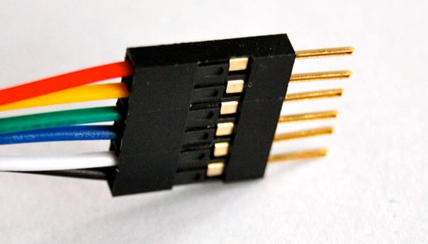

    I'm not sure how I do that. Does it require soldering something to the board?
    You don't have to solder - I am using a "pogo" cable to connect a USB-to-Serial adapter:
