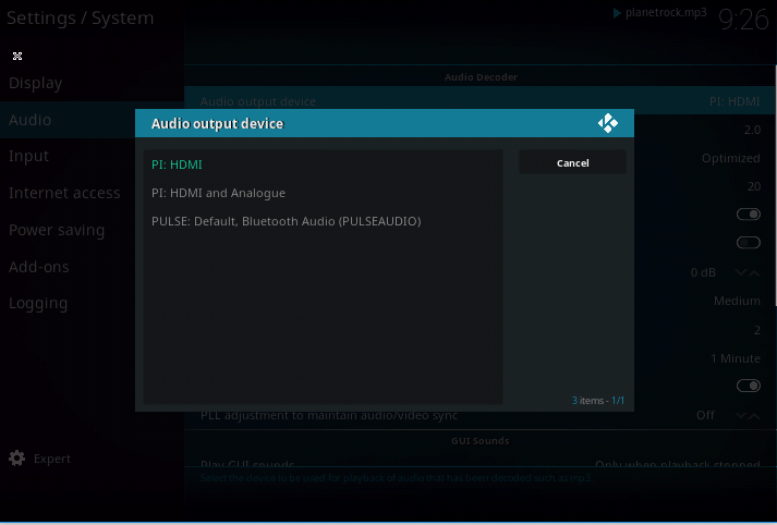

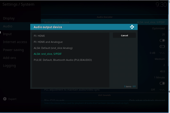

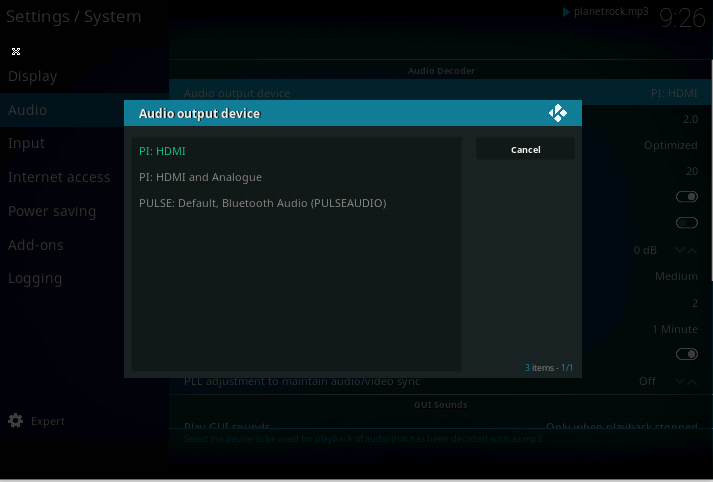

  • On 8.0.1 Slice3 release audio from the 3.5 mm jack works fine. On release 8.0.2 there are only three options for sound, no way to select the 3.5 mm outputs. as per the audio options setting page named for the release in the attched screen grabs. The left one is from 8.0.1 and the right hand one is from 8.0.2

    I can see the issue (audio and led drivers are not in the kernel) and I will build and push an updated 8.0.2 image sometime later today to fix it. I'll also see if I can beg a Slice-light kit from the folks at Pimoroni to replace the dead hardware I have.
