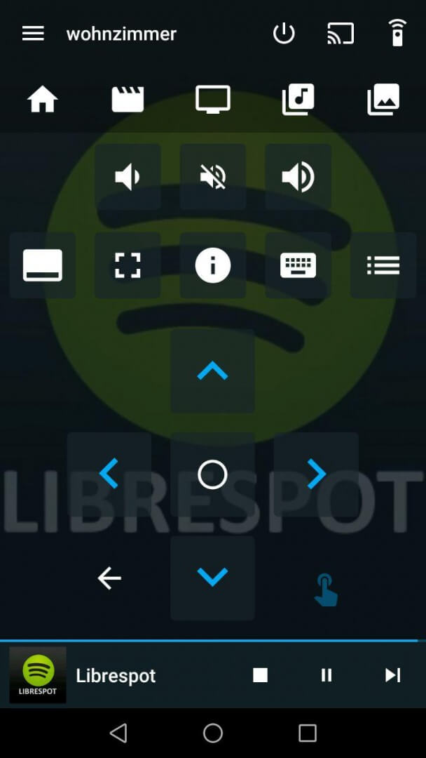

  • I have have updated streaming to Kodi
    this is a great solution for stopping spotify. and the test build works good, too.
    I have the feeling (as in: not validated via any means) that the delay/pause is a lot smaller.
    This looks good in Yatse, as well:
    Edited once, last by ZyanKLee ().
