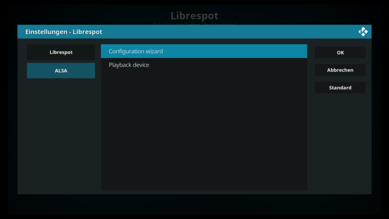

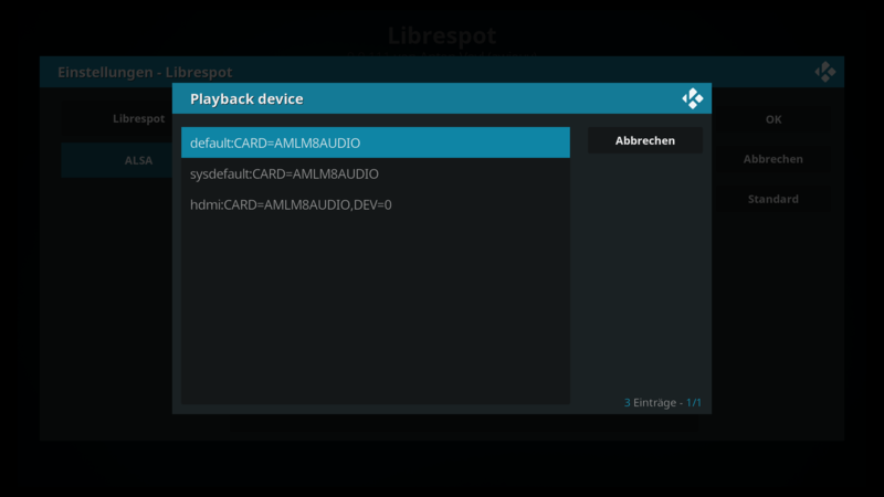

    The third screenshot is from the librespot settings. There it shows nothing in Playback devices (also after using the configuration wizard), but I assume this is a minor problem.
    Configuration wizard does not copy the selected device to Playback device anymore, because the behaviour of Kodi changed.
    I should try to fix that.
    In the meantime, you must fill in Playback device manually.
    What is displayed if you select configuration wizard?

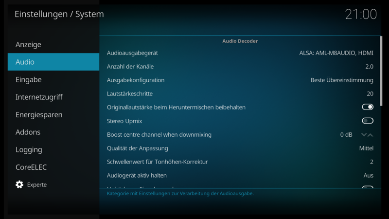

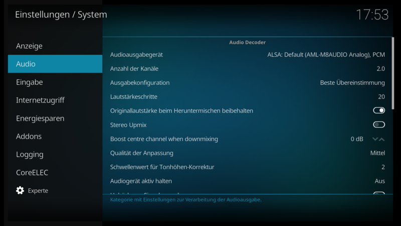

  • In the Kodi audio settings I can switch to ALSA: AML-M8AUDIO, HDMI.
    Then it seems to work, at least during the first tests. Good!
    I am not sure what is the difference between the 'ALSA: AML-M8AUDIO, HDMI' and the 'ALSA: Default (AML-M8AUDIO Analog), PCM' it was set to previously. It is not going over HDMI, only. I still hear it over the optical out and my audio receiver.
