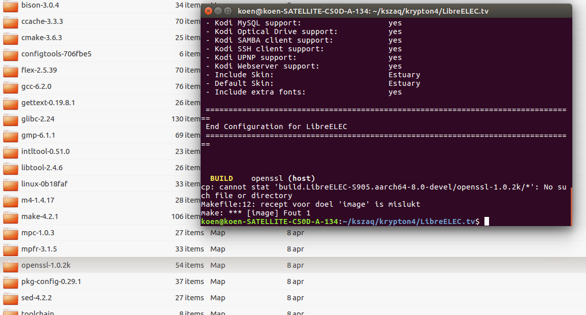

HTTP request sent, awaiting response... 200 OK
Length: 5309236 (5.1M) [application/x-gzip]
Saving to: 'sources/openssl/openssl-1.0.2k.tar.gz'
sources/openssl/ope 100% 5.06M 2.28MB/s in 2.2s
2017-04-08 14:45:32 (2.28 MB/s) - 'sources/openssl/openssl-1.0.2k.tar.gz' saved [5309236/5309236]
UNPACK openssl
APPLY PATCH (common) /home/koen/kszaq/krypton4/LibreELEC.tv/packages/security/openssl/patches/openssl-0001-ca-dir.patch
patching file apps/CA.pl.in
patching file apps/CA.sh
patching file apps/openssl.cnf
BUILD openssl (host)
cp: cannot stat 'build.LibreELEC-S905.aarch64-8.0-devel/openssl-1.0.2k/*': No such file or directory
Makefile:12: recept voor doel 'image' is mislukt
make: *** [image] Fout 1
koen@koen-SATELLITE-C50D-A-134:~/kszaq/krypton4/LibreELEC.tv$
Display More
I have tried, but getting this error?

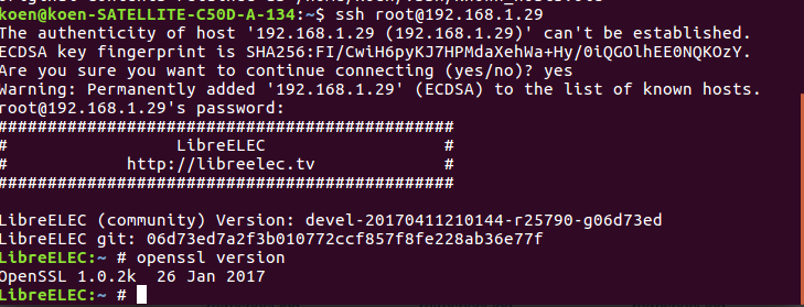

Finally, Retrospect is working!
LE 8.1 with openSSL.
