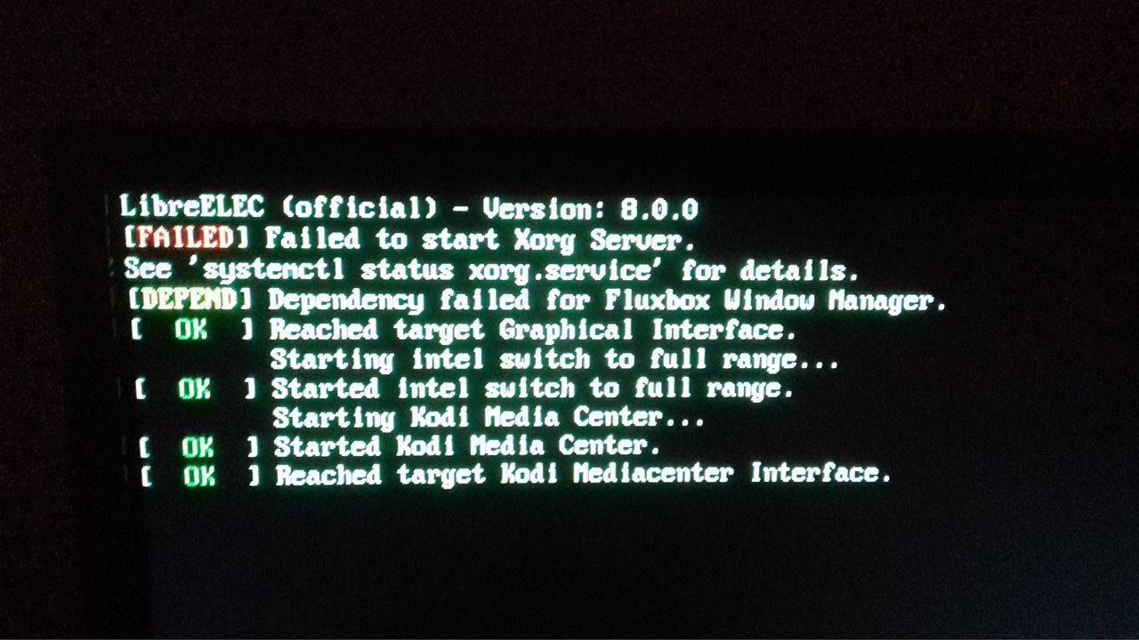

    The first one is this: I installed LibreELEC, then rebooted it, everything is ok, so i installed some addons. After I shut the pc down and then after start up I see this: 5a24xt.jpg (I don't have a debuglog because I can't connect ssh – i don't remember if it was allowed)
    I tried install the LibreELEC again. After installation and rebooting I did the basic steps after first start up. Then I shut the pc down – I tried to find out if that bug isn't doing some add-on. After start up I see cursor on black screen. I can move the cursor but that is everything I can do with it.

  • For some reason it is picking up your nvidia nforce chipset as a graphics adapter.
    You will have to modify the udev rule for it to work. I can post the steps later.

  • Looks like you just need one command via ssh
    touch /storage/.config/udev.rules.d/96-nvidia.rules
    then reboot.

  • The art of screwing up a relatively good install:
    The failure of starting xorg server used to happen once at two or three days. I have done exactly as per info, entering "touch /storage/.config/udev.rules.d/96-nvidia.rules" and then "reboot".
    Now the LibreELEC does not start, it stays stuck at xorg problem. I have rebooted and accessed ssh and entered the command again, the same result. Please take a look at the pictures. Please suggest what should I do.
    You have a Nvidia graphics card you so don't want this. To fix it just do
    rm /storage/.config/udev.rules.d/96-nvidia.rules
    then reboot
