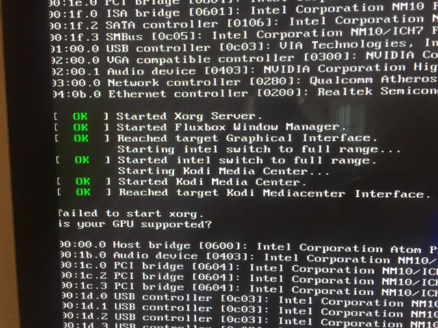

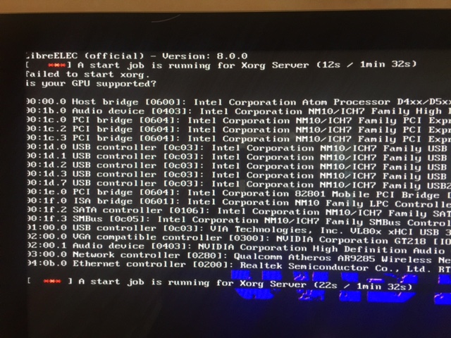

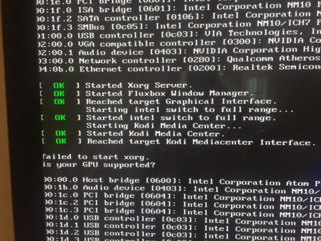

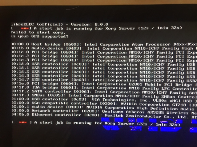

    The art of screwing up a relatively good install:
    The failure of starting xorg server used to happen once at two or three days. I have done exactly as per info, entering "touch /storage/.config/udev.rules.d/96-nvidia.rules" and then "reboot".
    Now the LibreELEC does not start, it stays stuck at xorg problem. I have rebooted and accessed ssh and entered the command again, the same result. Please take a look at the pictures. Please suggest what should I do.
    Looks like you just need one command via ssh
    then reboot.
    It happens to me too at boot. Sometimes during watching a video the image disappears and replaced with a black screen and then it comes back while the sound is working. I am not familiar with running a command via ssh but I will do some reading. (Update: done it after reading wiki)
