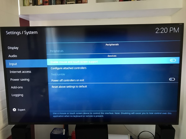

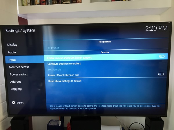

    Thanks for the suggestion. My peripherals is actualy greyed out, so I don't think that is it. Appreciate the input and I'll keep trying to track it down.
