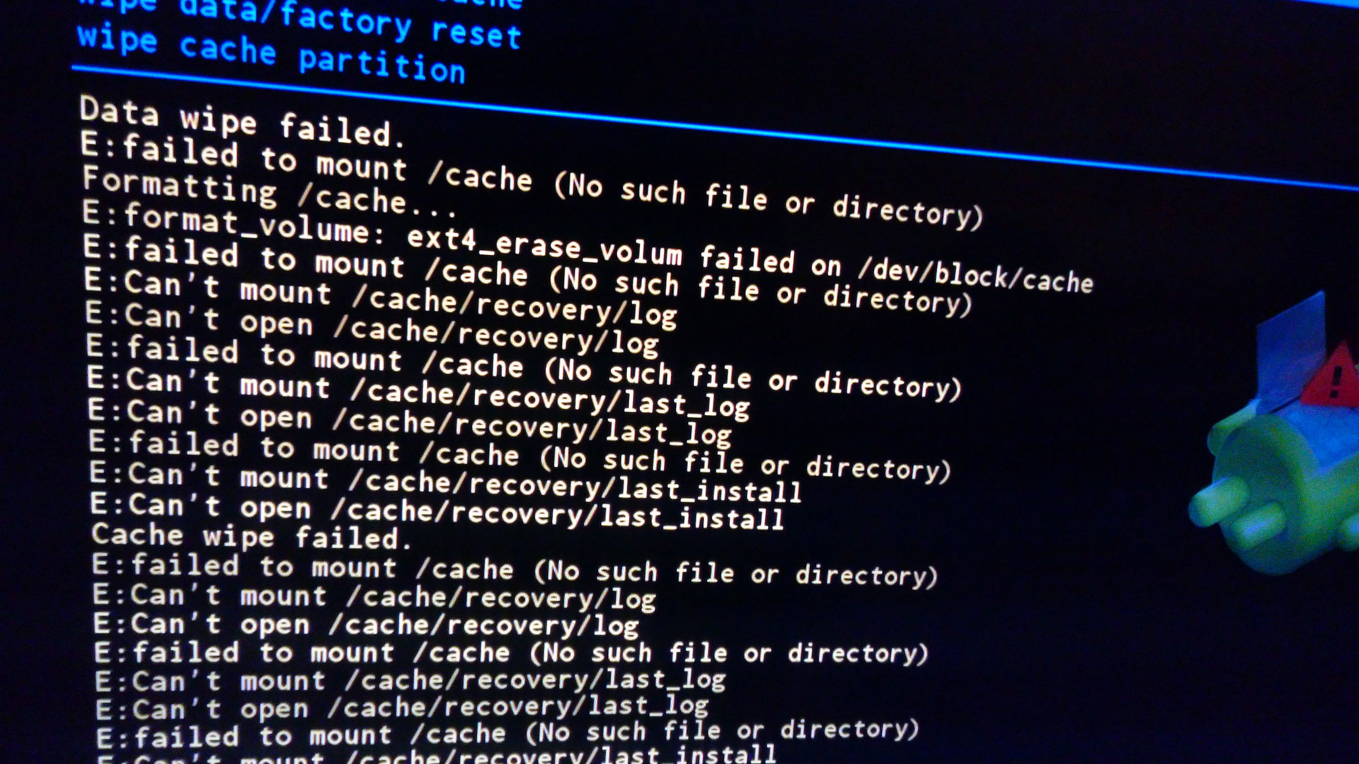

  • Damn! The nand in my box seems to get destroyed. Tried almost all recovery methods, including the BootCardMaker method, and nothing worked. Maybe I need another u-boot.bin for recovering but I am not sure. Took the bootloader.img and renamed it to u-boot.bin. Maybe someone has another idea I could try ( kszaq ? ). Otherwise I need to get another S802 Box.
    I appended a photo with the errors.
    PS: Could it be a temperature problem? The box is getting very warm.

  • @dreischel The only time I saw this issue was on a S905 box when u-boot supplied wrong command line arguments to recovery. Have you tried flashing factory ROM via USB Burning Tool? Also remove aml_autoscript from SD card as it may corrupt the boot process somehow.
