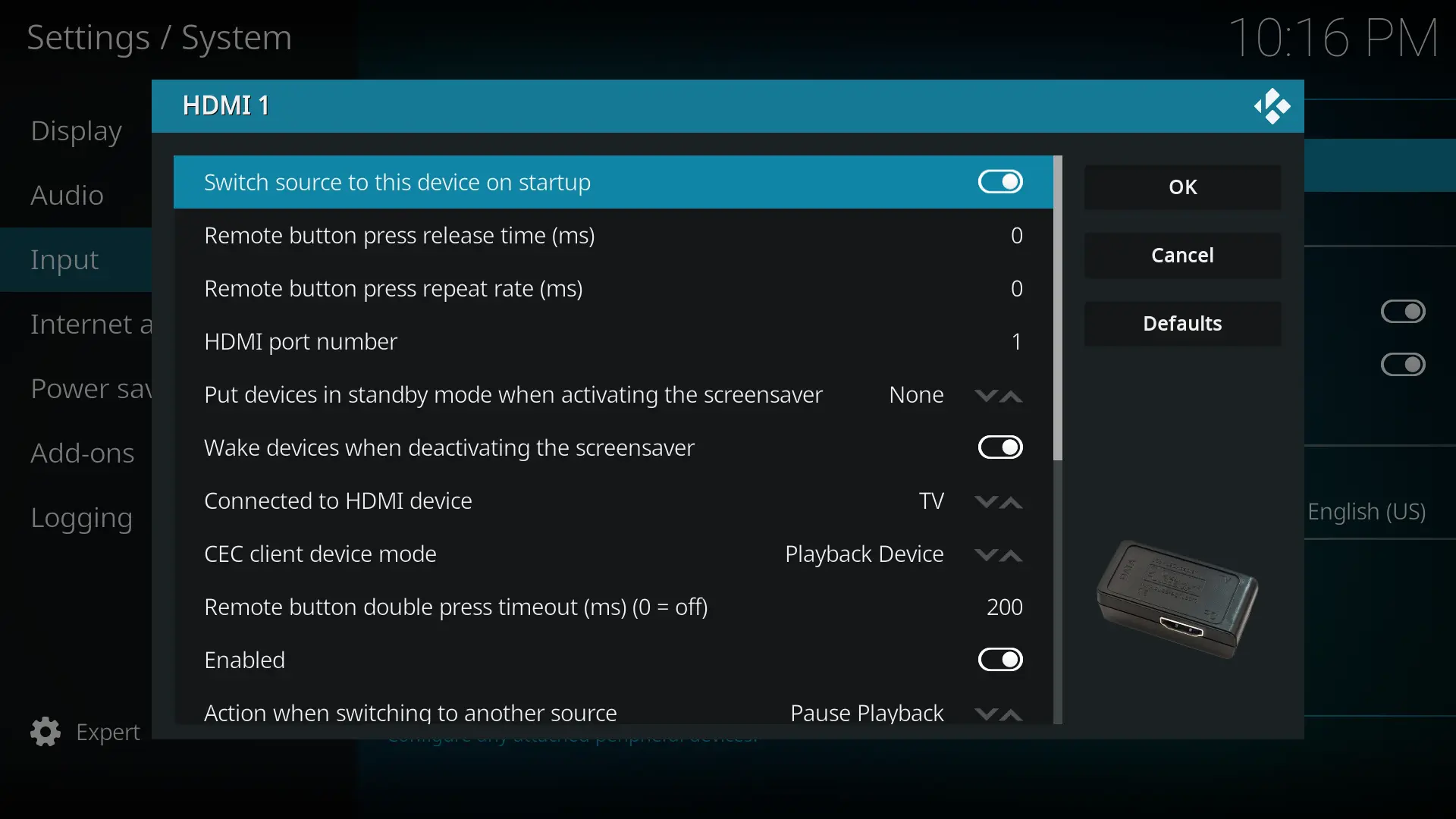

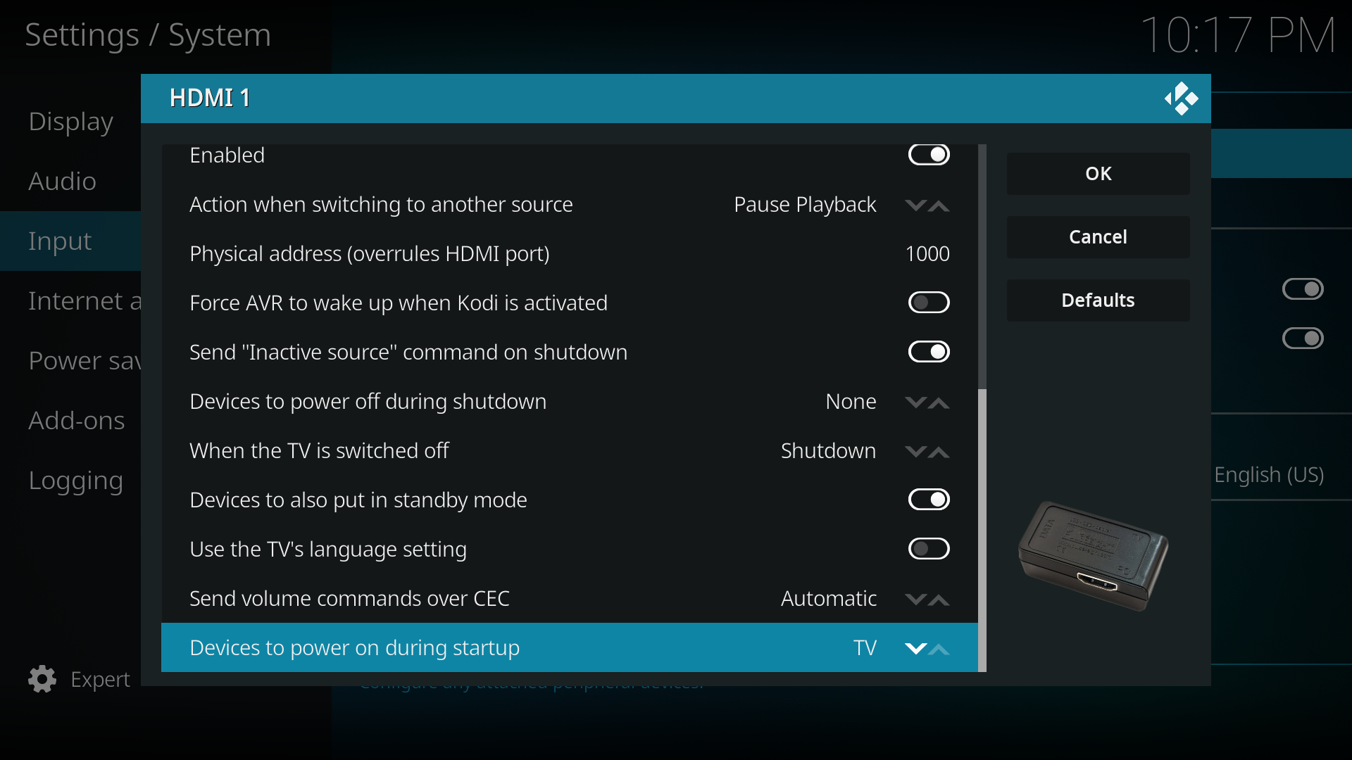

    Please post the current settings of your CEC Adapter within KODI GUI of the LE 13.
    Correct and correct.
