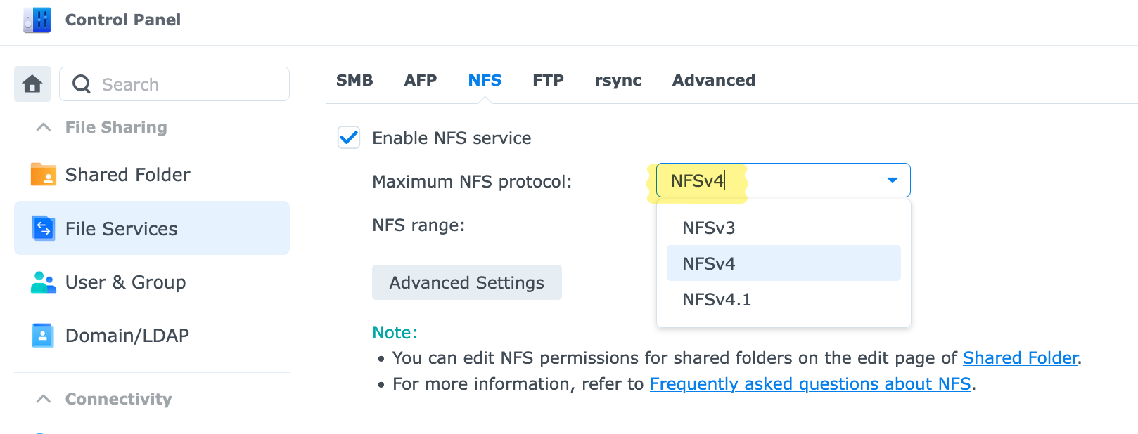

    2026-04-28 22:03:06.368 T:900     error <general>: NFS: Failed to mount nfs share:  (nfs_service failed)
    Why is that? Up until recently I never had any issues (since years) and didn't change anything on my NAS. Please see attached NFS version running on my Synology. Shall I set it down to v3 maybe?

    See attached newly generated log ... I also noticed that additionally a crash log was generated (attached as well). Could the NFS issues be due to a mismatch of NFS version (LibreELEC: 3, Synology NAS: 4)?
    In any case, I think I will make a clean, new install and verify all NFS related permissions in accordance with the Wiki to double-check.
