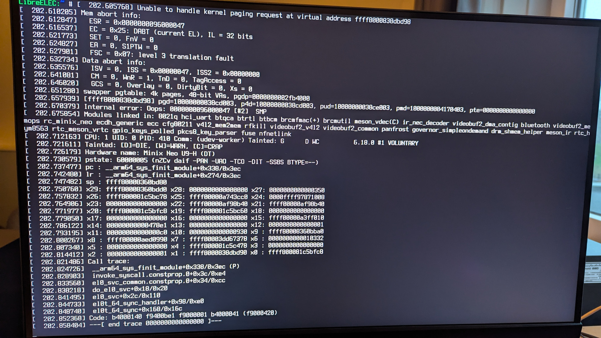

    Edit: after this, some more errors suddenly popped up on the screen. Of this, I took a picture:

  • The log looks clean except for a kernel splat from the broadcom SDIO module, which i'd interpret as a symptom of stability issues on the SDIO bus, which is a general issue with this era of hardware due to Amlogic silicon bugs. The upstream kernel contains general mitigations that work for most GXL/GXM hardware, but not all hardware, and the U9-H seems to be one of the boards with issues.
