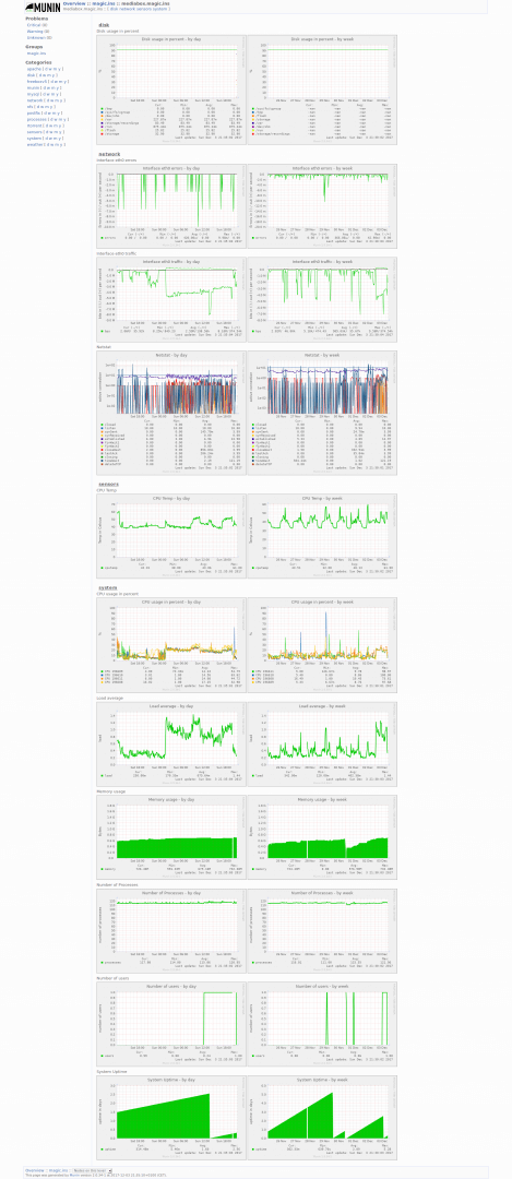

I'd be happy to be able to poll my LibreElec box by SNMP as well to monitor load and usage. Would fit great in a LibreNMS tool for example.
