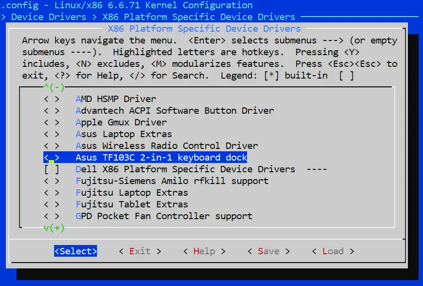

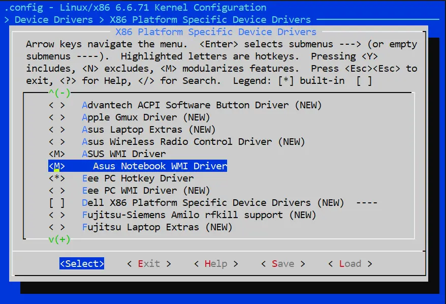

  • i have been building LE from this guide. i'm trying to enable linux kernel driver - platform - asus wmi and asus nb wmi. if i copy kernel config from project/Generic/linux/linux.x86_64.conf to build dir and do make menuconfig that two items did not show up.
    if i remove .config and run make menuconfig the two items that i want show up in the menu.
    is there any way to enable kernel driver that i need?

  • project/Generic/linux/linux.x86_64.conf does not have CONFIG_ASUS_WMI line.so i manually add these lines:
    CONFIG_ASUS_WMI=m
    CONFIG_ASUS_NB_WMI=m
    then i copy project/Generic/linux/linux.x86_64.conf to project/Generic/linux/linux.x86_64.conf.new
    i enabled 4 more asus specific kernel driver so i got something like this:
    ~/LibreELEC.tv$ cat projects/Generic/linux/linux.x86_64.conf.new | grep -i asus
    # CONFIG_USB_PEGASUS is not set
    CONFIG_SENSORS_ASUS_WMI=m
    CONFIG_SENSORS_ASUS_EC=m
    CONFIG_HID_ASUS=y
    CONFIG_ASUS_LAPTOP=m
    CONFIG_ASUS_WIRELESS=m
    CONFIG_ASUS_WMI=m
    # CONFIG_ASUS_TF103C_DOCK is not set
    to make sure that the config persist i ran command:
    PROJECT=Generic ARCH=x86_64 tools/adjust_kernel_config menuconfig
    i recheck CONFIG_ASUS_WMI=m and CONFIG_ASUS_NB_WMI=m and they where gone from menuconfig, while others 4 still remain. then i save the config and got something like this:
    ~/LibreELEC.tv$ cat projects/Generic/linux/linux.x86_64.conf | grep -i asus
    CONFIG_HID_ASUS=y
  • According to https://cateee.net/lkddb/web-lkddb/ASUS_WMI.html CONFIG_ASUS_WMI=m depends on CONFIG_HOTPLUG_PCI=y which you are not defining so the option is removed (unset) when the defconfig is saved.
    The patch below resulted in it being built:
    You probably don't need these:
