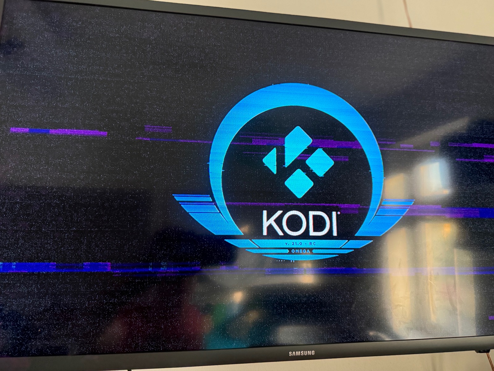

    Also, and this goes for Generic-Legacy too, the splash screen is broken. It shows the same “damage” on every boot (at least I think so), and it's been like that since at least LE11, picture attached.
  • The splash screen is broken. It shows the same “damage” on every boot, and it's been like that since at least LE11
    That's the Kodi Omega (21) splash screen. The glitches are intentional and part of the splash. Kodi Piers (22) moves back to a more normal one.

  • That's the Kodi Omega (21) splash screen. The glitches are intentional and part of the splash. Kodi Piers (22) moves back to a more normal one.
    Hehe I thought so, but then I saw another screenshot of someone else and looked broken in a different way (just a bit), so I thought, ok, the logo is supposed to be like that, but maybe the black/blue not :D
    If you are using "adjust refresh" in Kodi config so it switches mode to match the media being played can you disable that and force all media to 1080@60. If you are not using that, please enable that and define 1080@60/59.94/50/24/23.976 modes and allow mode doubling. Do the changes make any improvement?
    That was it! The match screen refresh rate was disabled. When I enabled it, it's fine on 1080p 60Hz (59.94 is also okay) and H264. H265 is still laggy, but it is expected, I think. There were no H265 HD decoders back then.
