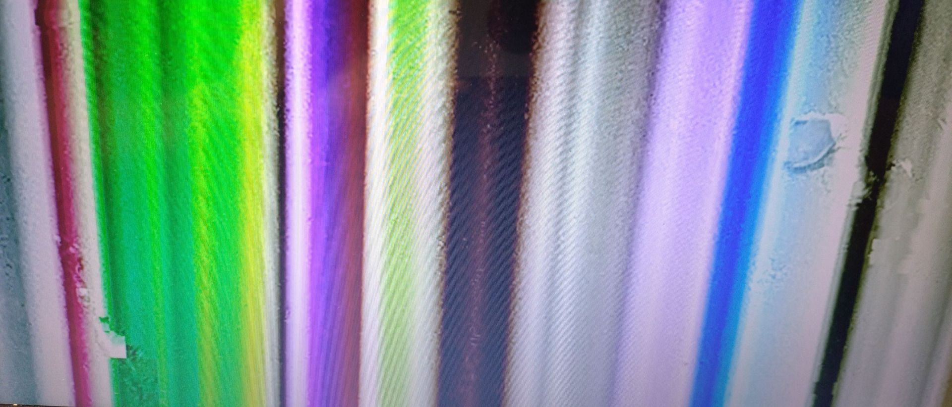

  • That did help with the black screen issue. However I'm still getting blurry elements most of the time, s. below. Network connection is stable as other videos run smooth. Also, other devices habe no such problems with the tested rtsp stream.
  • I'm fuzzy on the precise details in some areas ( popcornmix can probably describe things more accurately) but I think this is broadly what's happening:
    The H264 hardware decoder supports a maximum 1920x1080 resolution on both boards (RPi4 inherited the same IP block as RPi3) and you are trying to play 2560x1440 resolution media on a 1024x768 monitor. As hardware decoding cannot be used because the resolution is too large the boards fall back to software decoding + resizing to match the output resolution + adjusting from 15fps to 60fps refresh rate (the only easy bit). RPi4 has the CPU grunt for the task so you see output. I'm unsure why RPi3 shows a blank screen where RPi4 shows output, but this is probably due to a capability difference between RPi3 (1080p max) and RPi4 (4K capable) so display pipelines are not equial. Disabling DRMPRIME in Kodi disables hardware decode and changes rendering in the kernel DRM layer; hence you now see something on RPi3 instead of nothing, but I'd guess it's still beyond the capabilities elsewhere in the pipeline so it's not usable output.
  • The monitor is actually 16:9 and supports a higher resolution. The 4B also makes use of this, but the 3B+ only offers 640x480, 800x600 and the selected 1024x768. I couldn't get it to set higher one, or any in the correct format.
    Still this doesn't seem to be the only problem. I tried a 640 stream and still got the blur for most of the screen (about two third, interestingly the top third works quite well, and below that it blurs).
