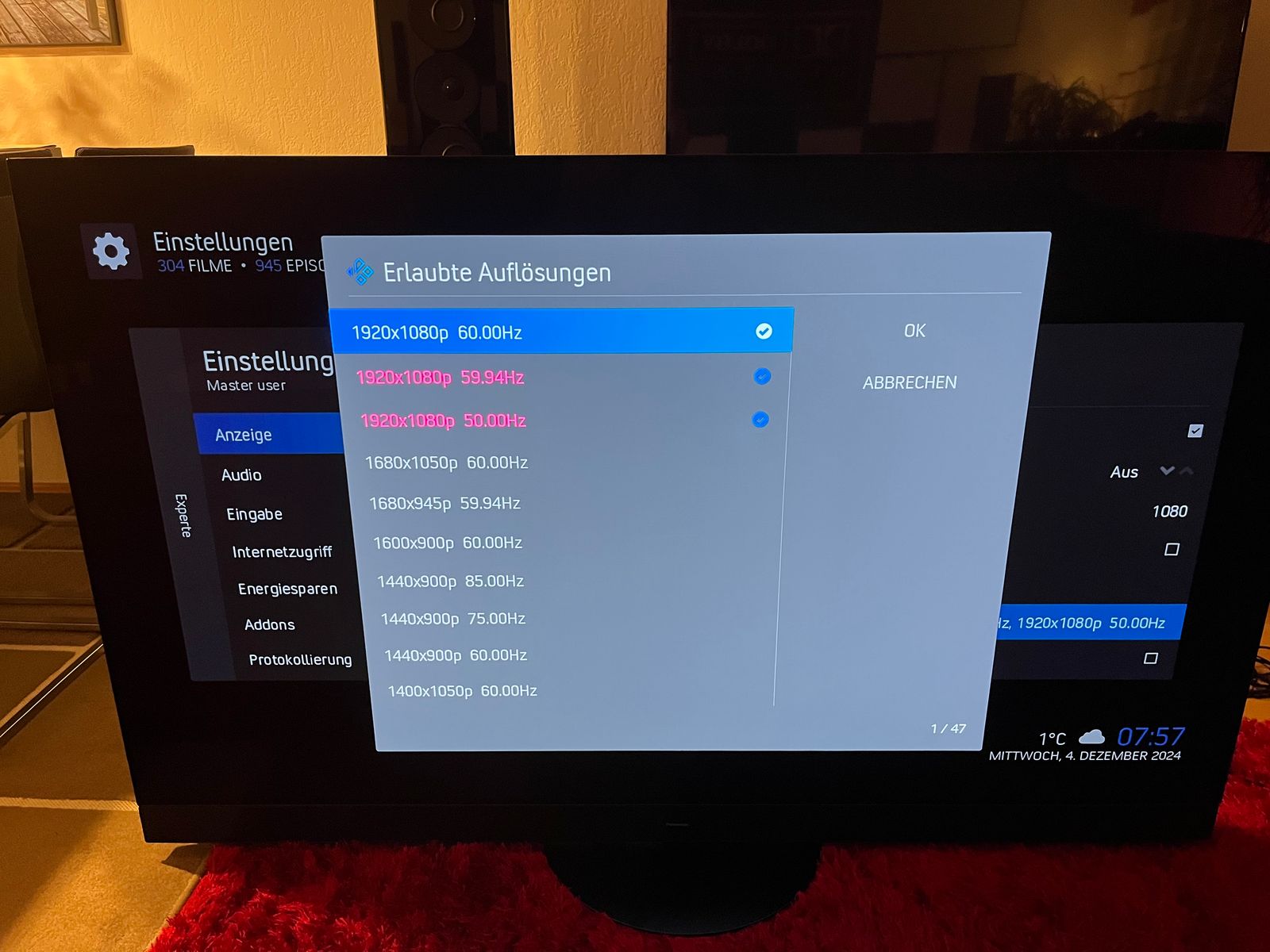

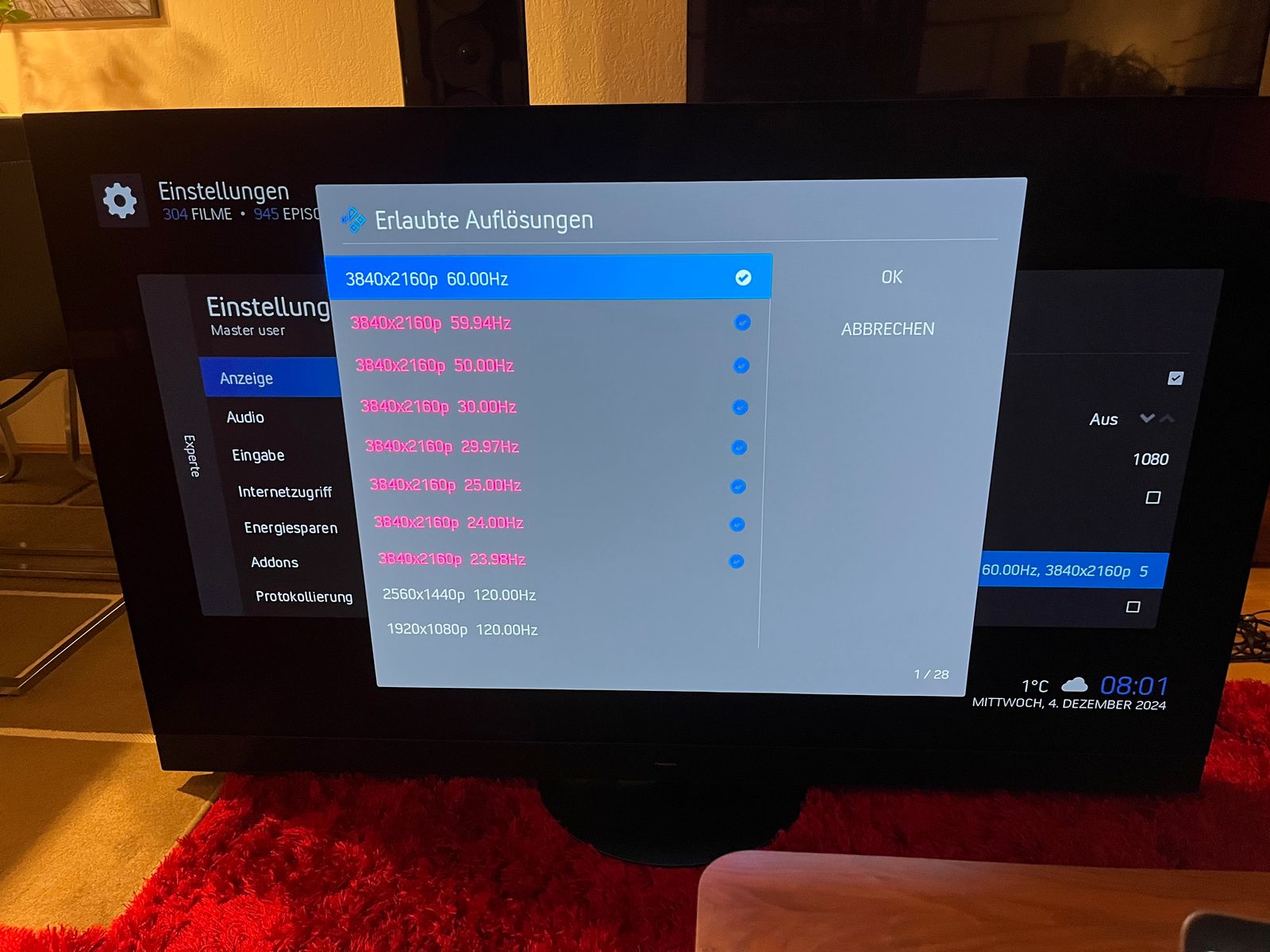

    Hi chewitt
    Thanks for your reply.
    I know the Wiki Link and i fully agree. GUI should be 1080p, i would like to set resolutions in the whistelist.
    But i cant!
    Pls look at the screenshots. With AVR i cant set 2160p, direct connect from PI to TV i can set it.
    How can i force the whitelist resolutions?

    All HDMI Ports are full. I have a Denon X4800H from 2024 and he has 8k Support.
    Following case is working (until reboot!)
    - Pi direct connect to TV (4k recognize)
    - Switch HDMI Cabels to Pi --> Denon AVR HDMI IN --> Denon HDMI Monitor 1 OUT --> TV
    WORKS until REBOOT
    Why is it not possible to generate an edid file and force this edid if the PI is booting?
    What im doing wrong?
