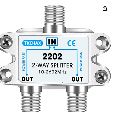

    Did you mean about antenna connection? Use a simple RF antenna splitter, something like this:

    VLouis I've never used that kind of RF antenna splitter, I only used others like this one, but usually it has a signal quality loss
    TV antenna splitter 2way F/MM 2221M metal | Stephanis

    I'd recommend a 3.5" HHD not a 2.5" SSD as the 3.5" HDD will be powered by its own PSU. You may hit power draw issues if you use 2 x USB tuners and a USB SSD all powered by the Pi 4 PSU - though an official Pi PSU may be OK. There's no real reason to use an SSD for PVR purposes unless you need it to be silent.
    The RF splitters shown are identical - they are both passive splitters (just one has Belling-Lee and other F-type connectors) - you will need a strong signal from your antenna/aerial if you split it between two tuners like that (as each tuner will get 50% of the signal effectively)
  • I've never used that kind of RF antenna splitter, I only used others like this one, but usually it has a signal quality loss
    Something like that it could be enoug, no need to be exactly the same.
    Because it's a passive splitter, always exist a signal loss. Something splitted in two, always result two halfs. The question is, that "half" will be enough for a tuner or not.
    Usually a good antenna could povide enough signal for two tuners, you should check it. If not, you could try to use a short antenna cable as possibile, or/and an RF amplifier. The beter could be to use an antenna with built in amplifier.

    Yes - all my DVB-T/T2 stuff is fed from a roof-top antenna system with a strong signal. I have a good quality active splitter to feed multiple DVB-T/T2 tuners as the signal has a good SNR so any noise increased by amplification isn't a problem.
