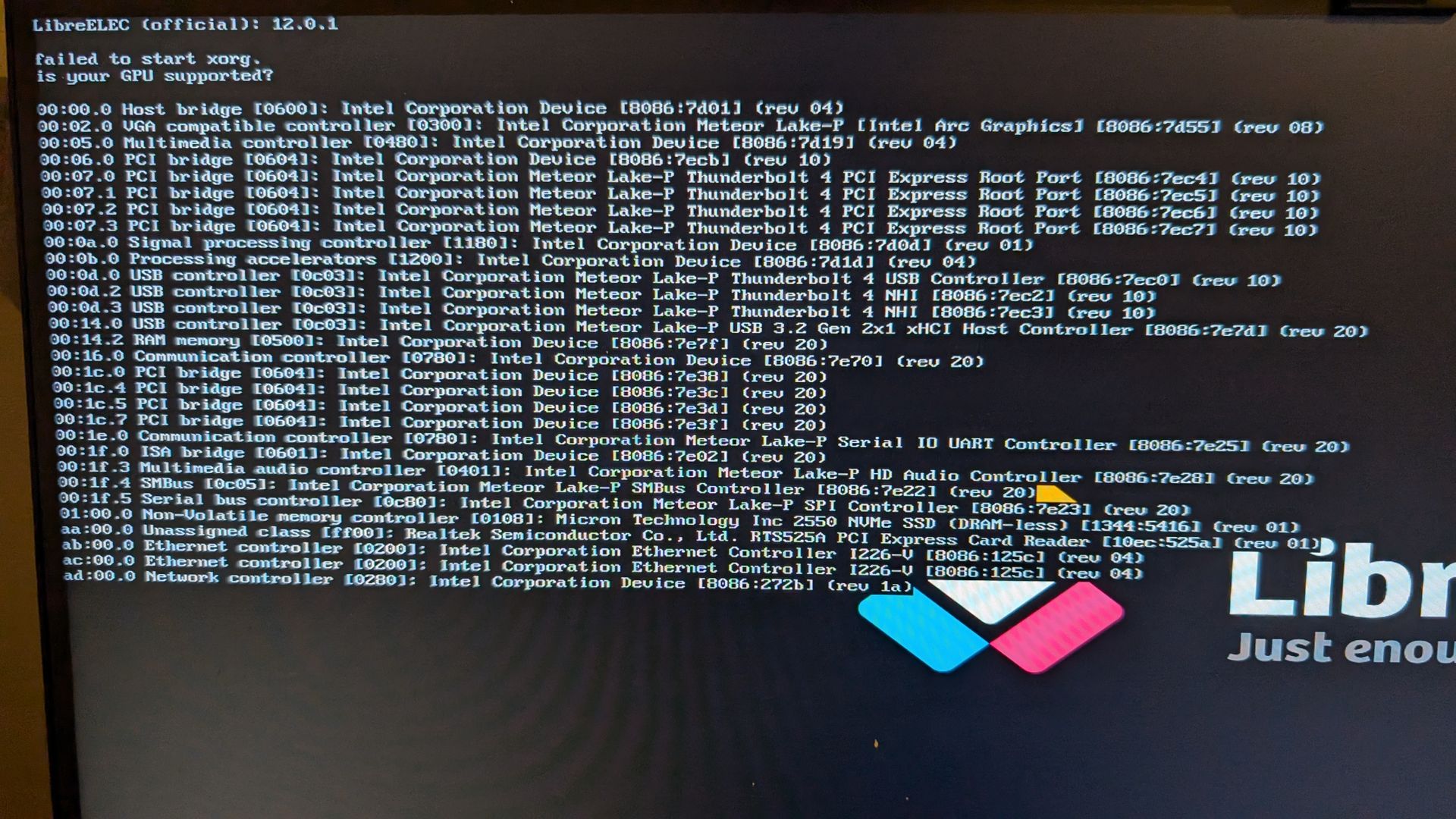

I am trying to install Libreelec 12 and have already tried a lot of versions and USB sticks but I always end up on the following screen

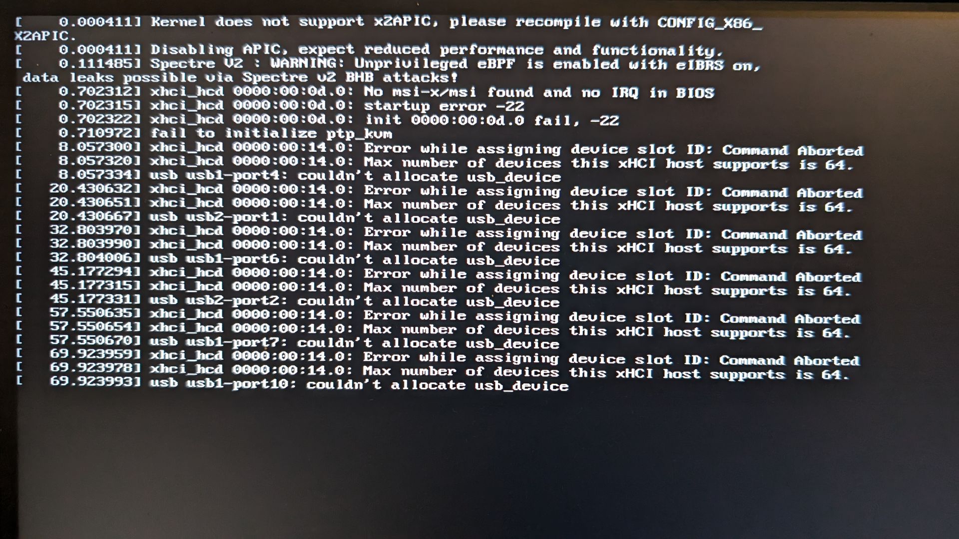

Can you disable x2APCI at BIOS?
Thanks a lot for your prompt response.
Disabling x2APCI fixed the install process but now I am stuck on the LibreELEC start screen with no response.

SSH is not possible since the first time config wizard is not coming up. It remains on the LibreELEC logo
In case of Generic, try Generic-legacy:
on legacy is end up almost same but with more information

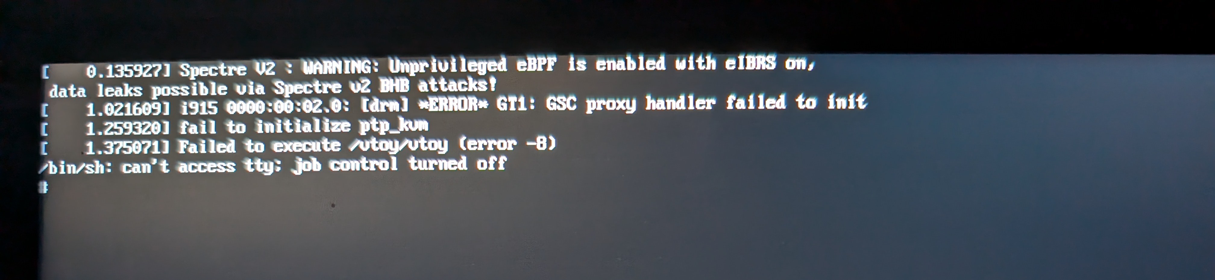

thats the error from the latest 13 nightly
drjackel - im not sure in the /vtoy/vtoy error that is coming up. are you running some bootloader or ventoy or ??
you are right. Issue is fixed with writing the img with dd. Thank you!
