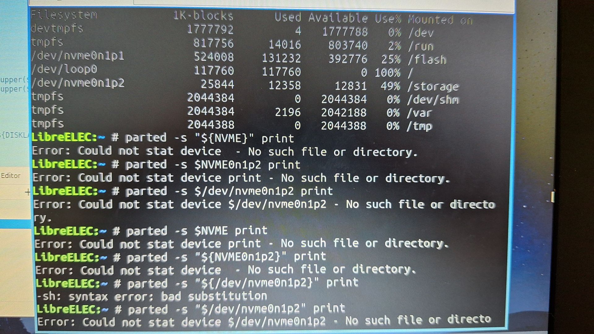

    Here is what in working with.
    I am NOVICE when it comes to Linux. I've build a Linux laptop to learn on and that is about it. I keep getting error messages as I do not believe I am correctly entering the information you provided.
    Any additional help and guidance is appreciated. Thank you.
  • A few thoughts:
    a) Check if the SSD is using a logical sector size of 512 bytes, 4096 are not supported. Use parted -l to test.
    b) The resize operation will create a /flash/fs-resize.log
    c) There are resize issues fixed in LE12 nightlys.

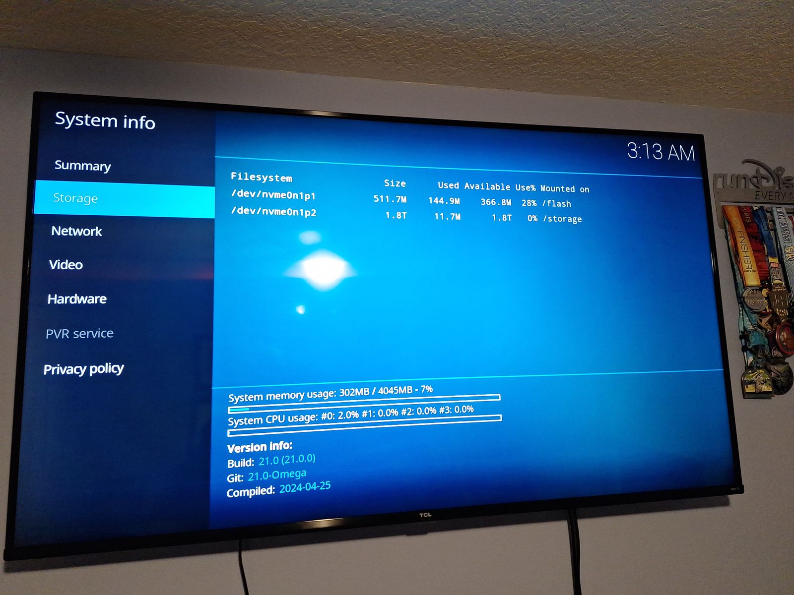

  • Don't ask me why, but I came home from work, turned the system on, and bam. Looks like I have the space now. I literally have no idea how.
    It only connected to my 5G on the wifi now but it's working. Samba running. You guys have been a great aid! Let's hope for all of your sakes the next time you hear from me, it'll be to buy you a beer.
