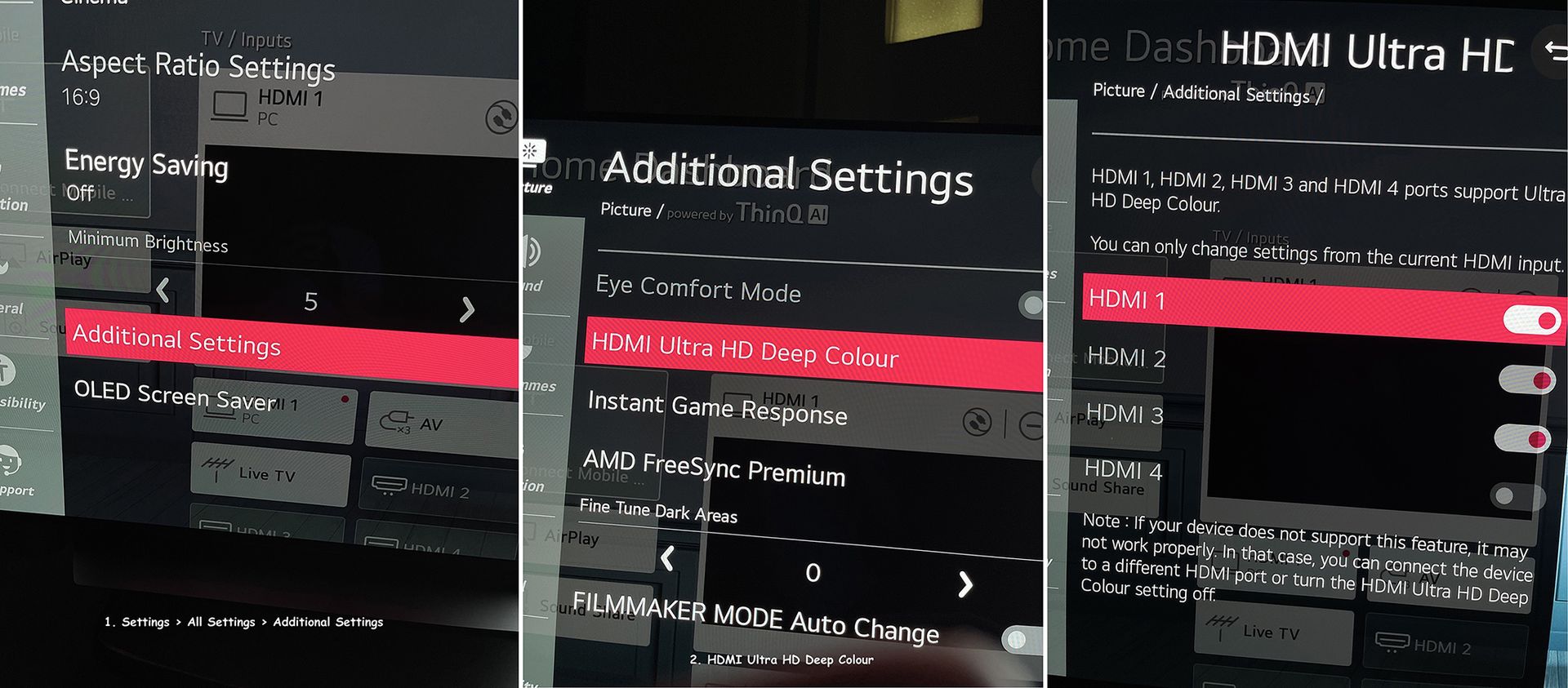

  • You probably need to enable HDR modes for specific HDMI sockets. Something like "Enhanced Mode" or "Deep Colour Mode" or such (there is no standard term).
  • All the settings on the TV were set to the ones mentioned above. I ended up solving this by reflashing the libreelec image on my thumbdrive and reinstalling. Now it is working without any issues! Thanks for your suggestions everyone
