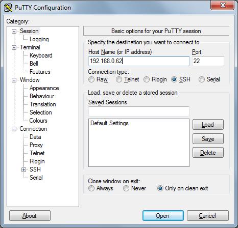

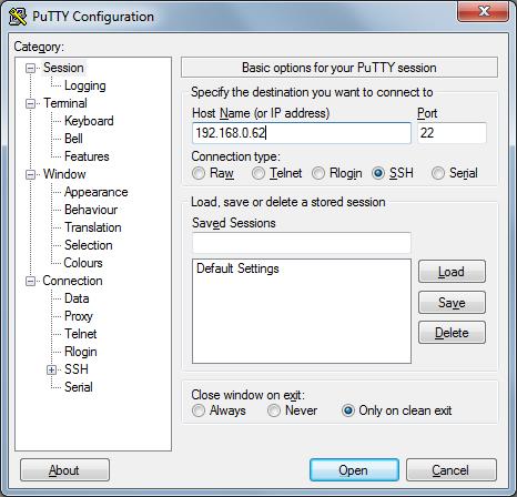

One more question - how do I get into the console to write the system to the internal emmc with the install2emmc command?
- Best Answer

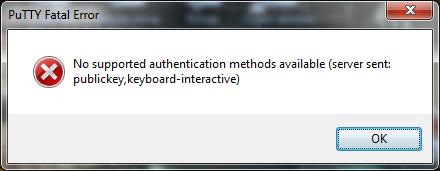

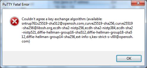

How old is the version of PuTTY?

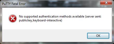

Yes, you are right, I had an older version of the program. I updated it, but now when I enter the root login a window appears and the connection is terminated at that point

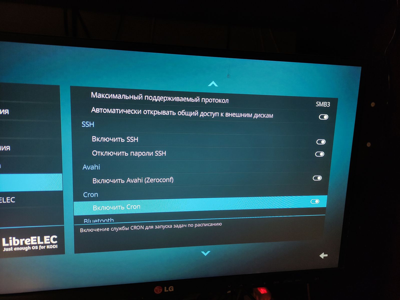

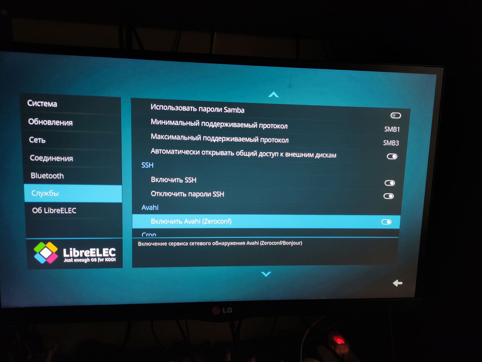

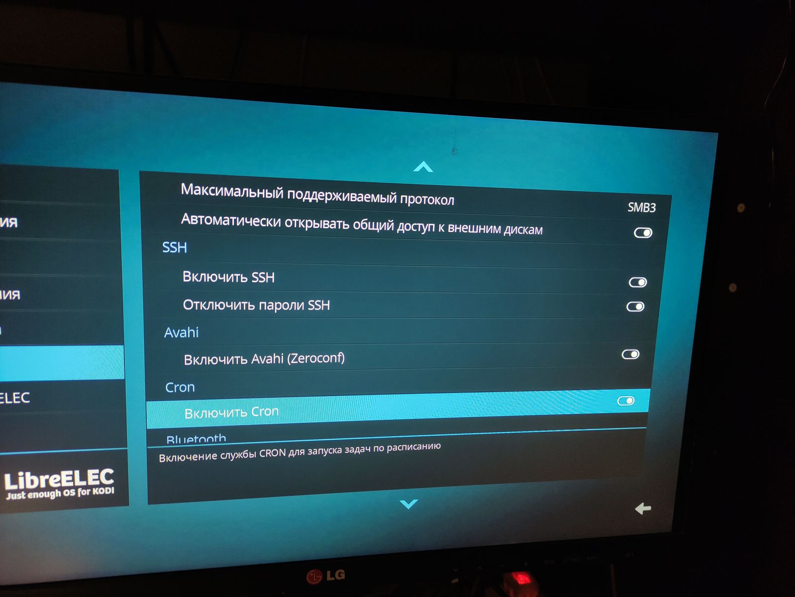

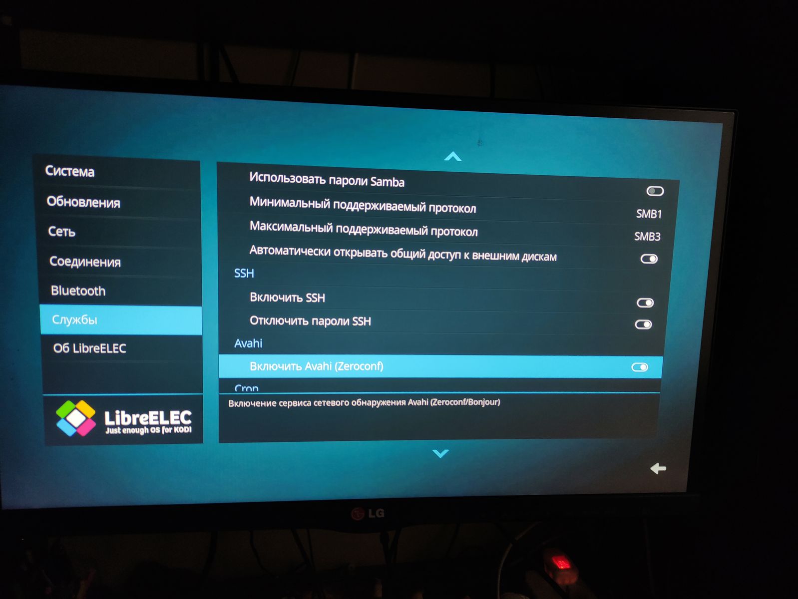

Have you enabled "disable password auth" in the SSH server settings (in LE settings)?
