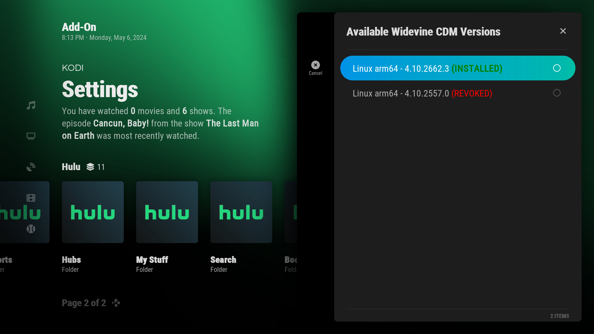

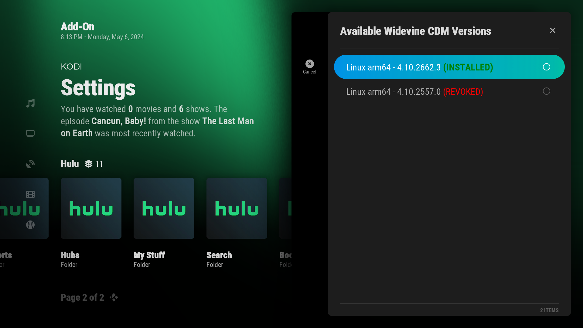

    This did indeed cause the Hulu add-on to prompt me to download a new Widevine library file. Confusingly, for me, is that all of the options shown are still for arm. There isn't any option to pick an "aarch" library, which is what I expected based on the released announcement. But maybe these are interchangeable? In any case, I then chose the only available one "Linux arm64 - 4.10.266.2.3".

  • Your 64 bit Widevine update was successful, because this error doesn't appear on your latest log:
    2024-05-02 20:57:11.847 T:13837   error <general>: AddOnLog: inputstream.adaptive: Initialize: Initialize: Failed to load library: /storage/.kodi/cdm/libwidevinecdm.so: wrong ELF class: ELFCLASS32
    Now there is something wrong with the new 64 bit Widevine:

  • You can downgrade Widevine on InputStream Helper. That did the trick for my DAZN problem (missing menu icons)
    Don't think he can downgrade widevine while still using LE12...once you update to LE12 the old version won't work and needs to be updated..it's more that the addon he s using needs to be updated too.
  • Don't think he can downgrade widevine while still using LE12...once you update to LE12 the old version won't work and needs to be updated..it's more that the addon he s using needs to be updated too.
    Yes, it's very likely that the user has no older Widevine available on InputStream Helper. However, he/she can get an older version from other internet resources, and manually copy & paste into the CDM folder.

  • Well, I tried the Disney+ to see if another DRM plugin would work and it doesn't. Disney+ actually crashes the whole system versus just freezing: https://paste.libreelec.tv/helping-chimp.log
    Then I tried to re-install widevide via InputStream Helper (instead of it being prompted thru Hulu). That didn't make any difference as Hulu still hangs in what looks like the same way. Here is that debug log: https://paste.libreelec.tv/decent-oryx.log
    So I per the suggestions here, I guess I will start to investigate getting widevine from another source manually and see if that can work.
