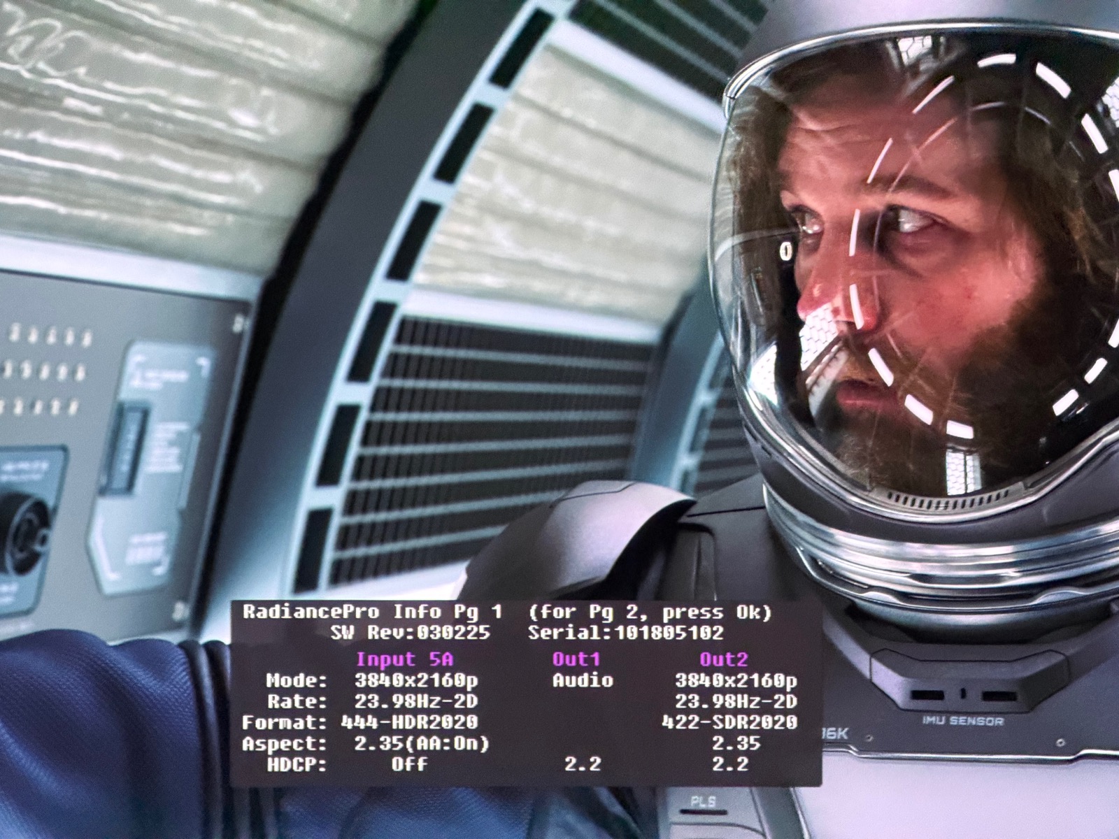

[x86-64] How to force YUV 4:4:4?
  • This works perfect, i have to use the 10-bit option otherwise i get dropouts.
    However i noticed that the video output refresh rate is 23.95, not 23.976 which creates stutters. Any ideas?
  • Kodi rounds values in GUI/logs and often reports 23.98 when the actual rate is 23.976. So if you're seeing 23.98 all is fine. If you're truly seeing 23.95 then something is wrong.
