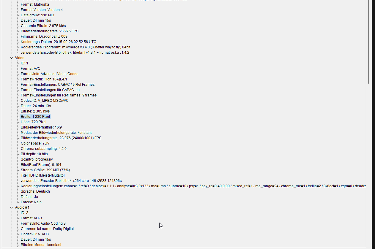

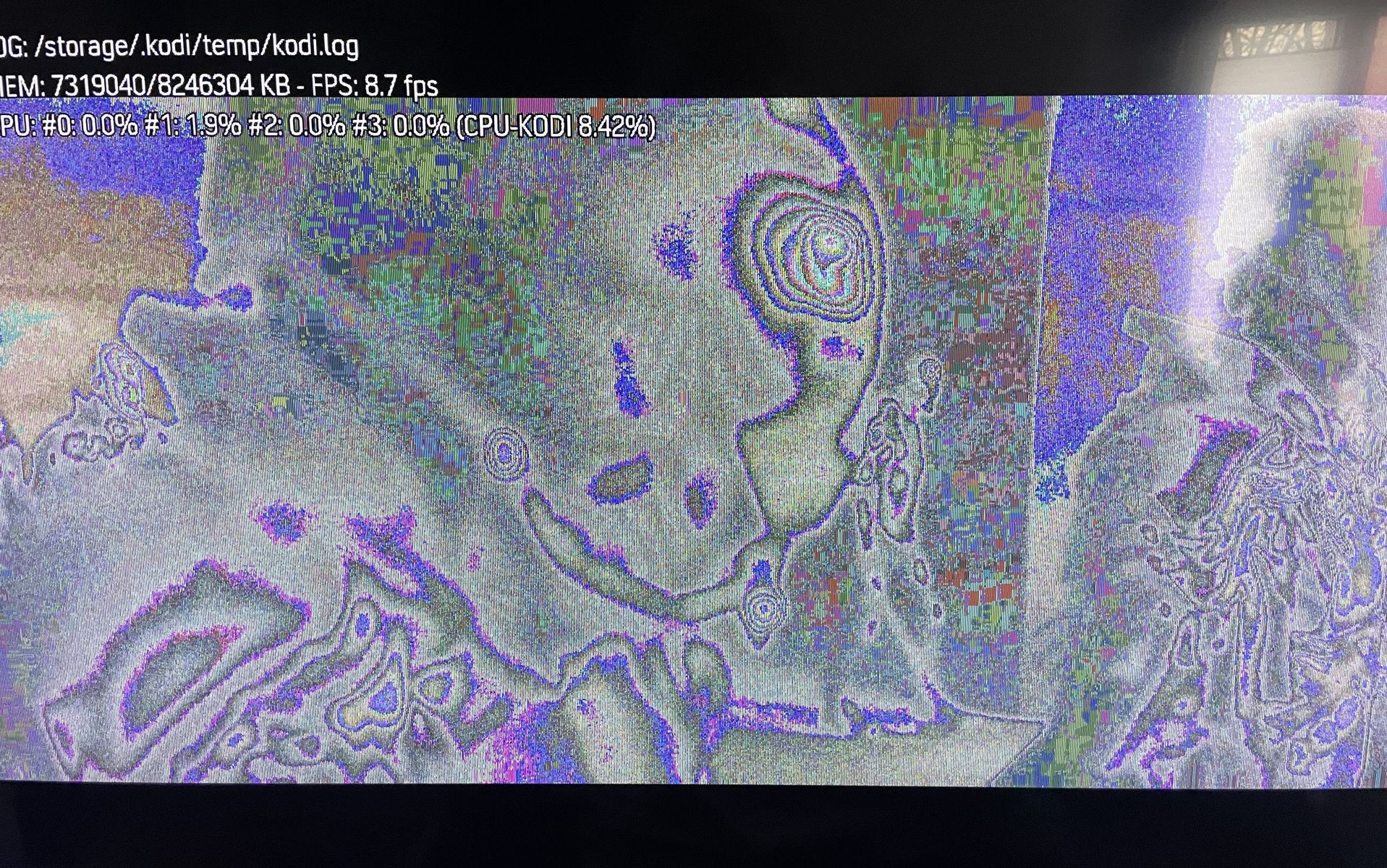

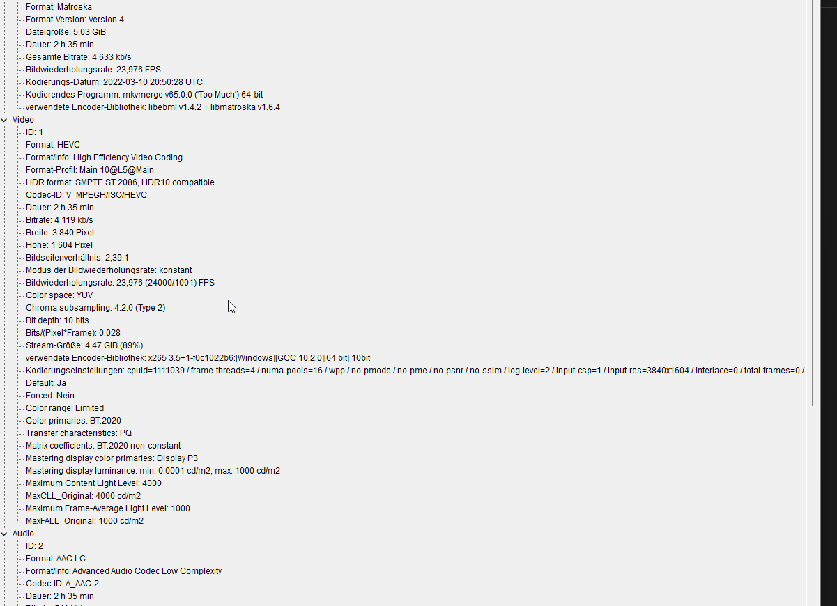

  • Hi,
    I tested some youtube videos with 2160p and VP9 and they work well.
    But some files like the attached ones have multiple artifacts, what i am wondering 720p as well ...., what can i do?
  • I can see the first is H264/10-bit which isn't a real-world broadcast standard and thus is often under-supported in software.
    Share samples of the files and we can ask Pi devs to comment.
