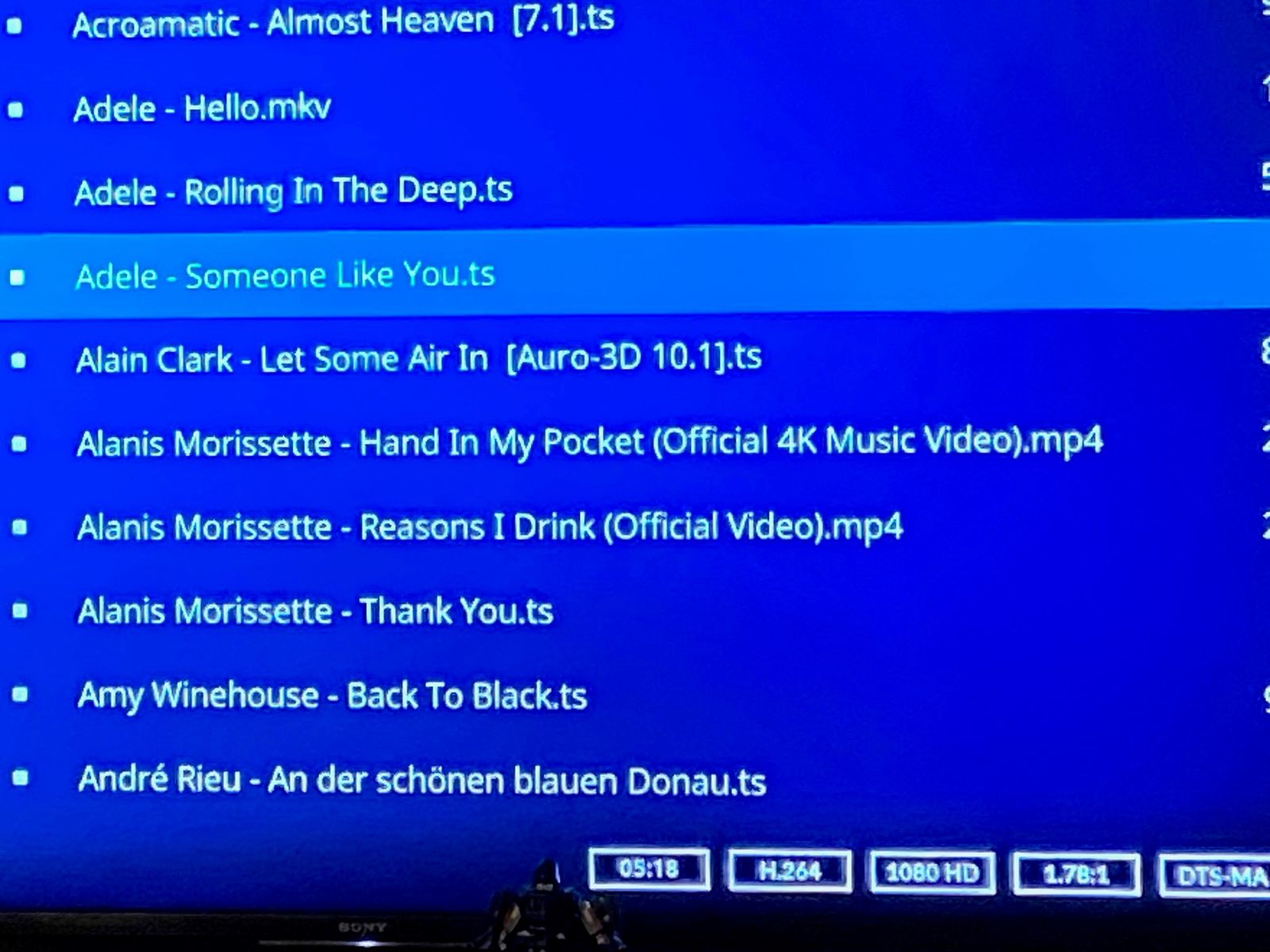

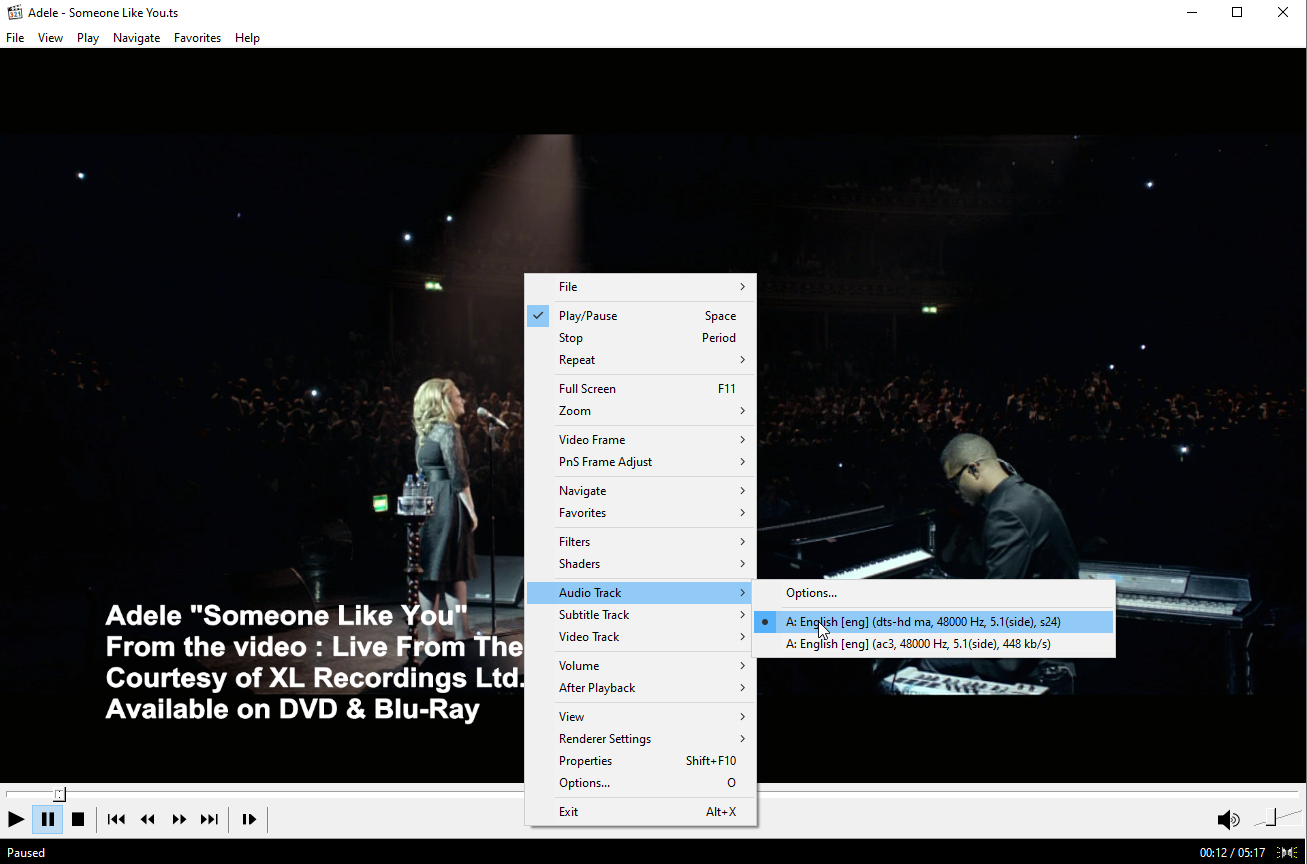

    Now in in the attached images, looking at Image 1, you can see that the file has DTS-HD Master Audio soundtrack. That shot was taken on my Windows PC... and I do get DTS-HD there.
    In Image 2 you can see that the KODI file listing it clearly states that it has that HD audio track. Now bear in mind that all of my movies that have the same audio track work perfectly fine with DTS-HD MA and DTS:X IMAX, Dolby True HD etc.

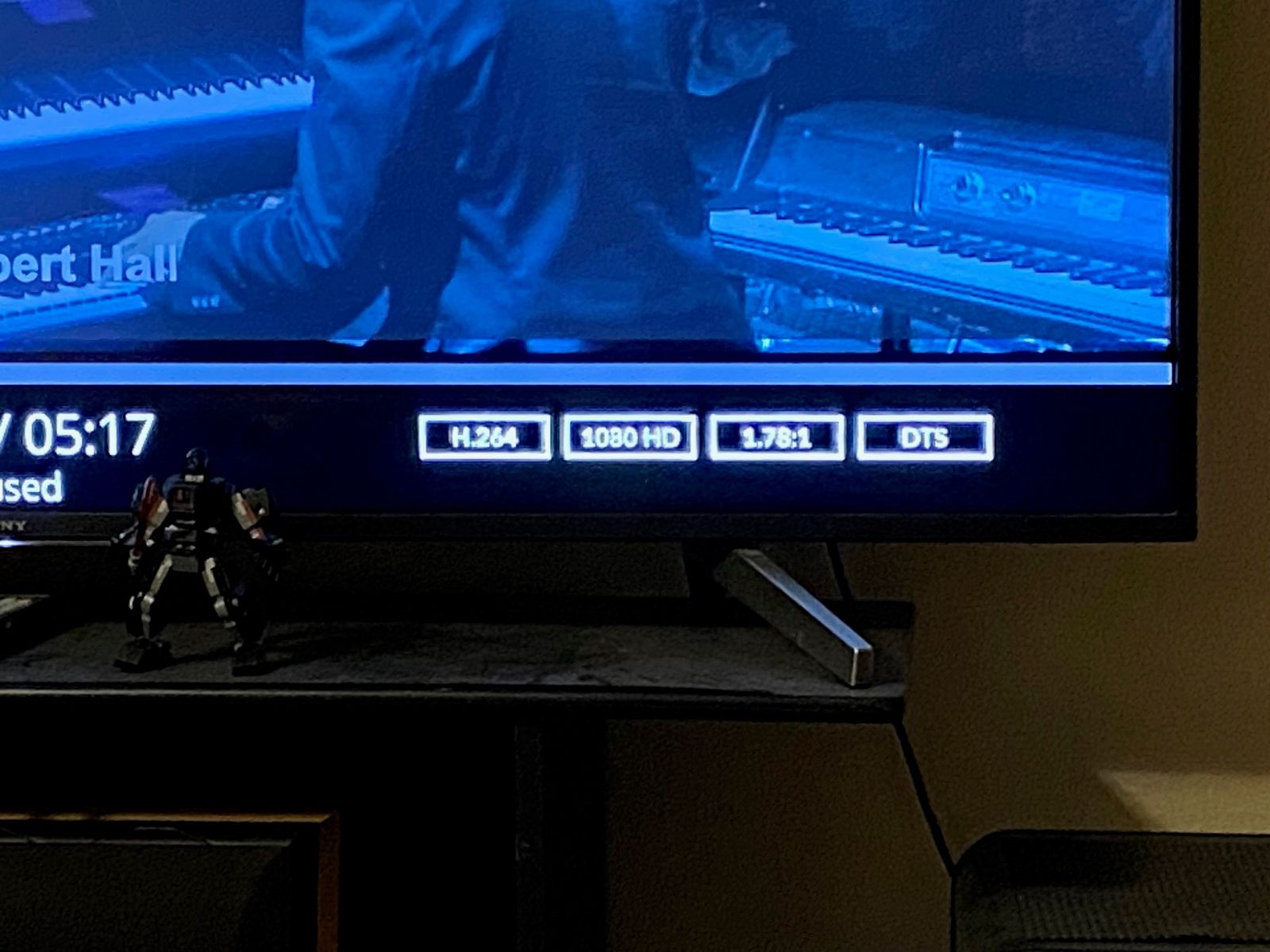

    In Image 3 you can see that the file is only playing in DTS. And in Image 4 you can see that I only have Dolby Digital and DTS. No HD tracks anywhere. If I revert back to 19.5 Matrix these files work perfectly with DTS-HD MA.
    I also looked at the log above and saw DTS HD Core there, so it's definitely there but for some reason the latest KODI version is blocking music videos HD audio tracks. Really odd I know. All of my music videos that have HD audio won't work with Nexus and I just get standard Dolby or DTS. Where Matrix they work fine.
