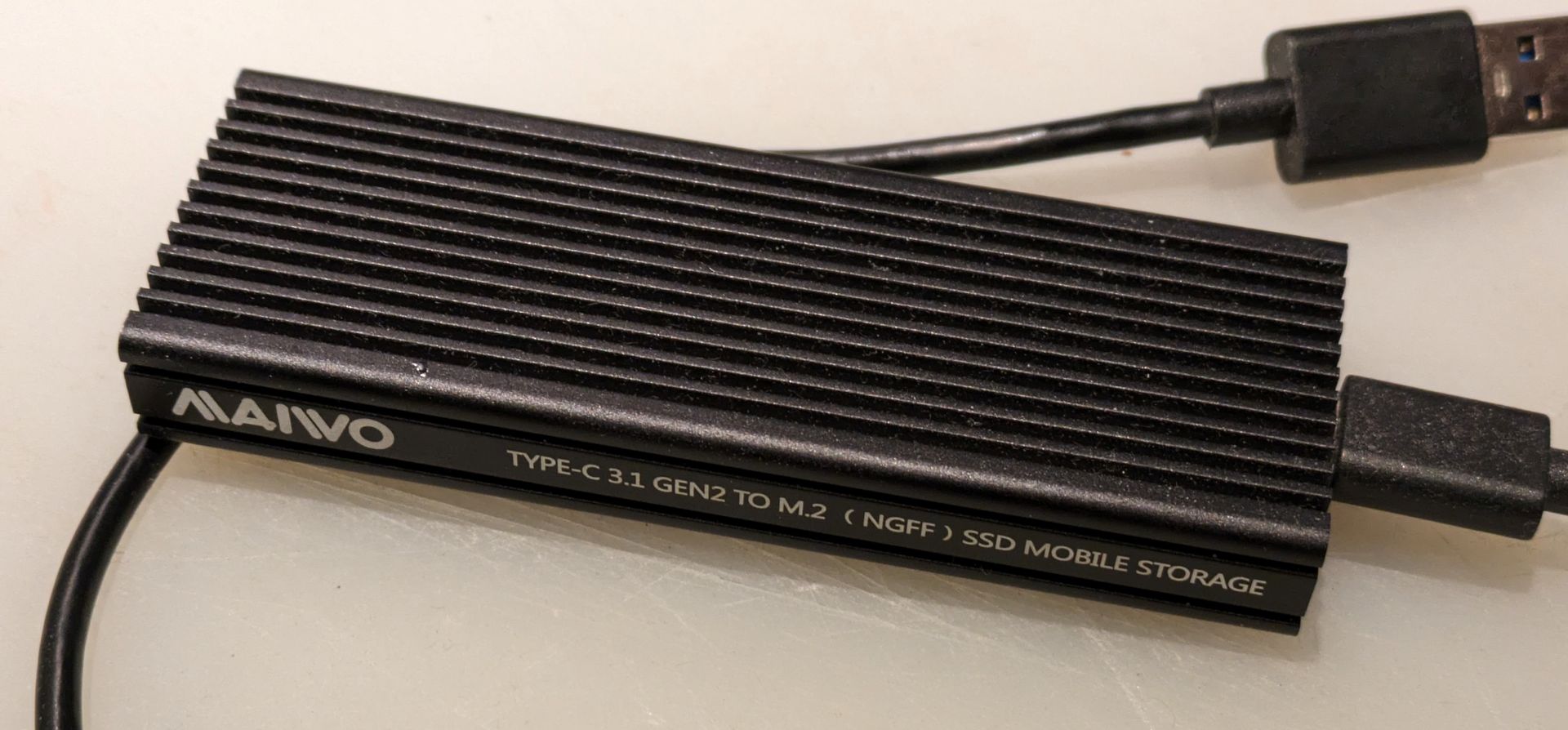

  • I didnt buy any extra hardware, no M2 hat, not even an SDcard, i had one of these with a Samsung 250GB M2 in it lying around collecting dust, installed LE12 on it using one of my Win 10 pc's and booted Pi5 from it, works like a charm.
