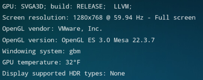

  • I found an answer here. I had to add these 3 lines to the virtual machine VMX configuration file.
    mks.enableDX12Renderer = "FALSE"
    mks.enableDX11Renderer = "FALSE"
    mks.enableGLRenderer = "TRUE"
    With them both the 9.2.6 and 11.0.6 OVA run properly under VM Workstation 17.5. There are a number of reports on the Internet about the graphics changes which VM Ware introduced with 17.5.
