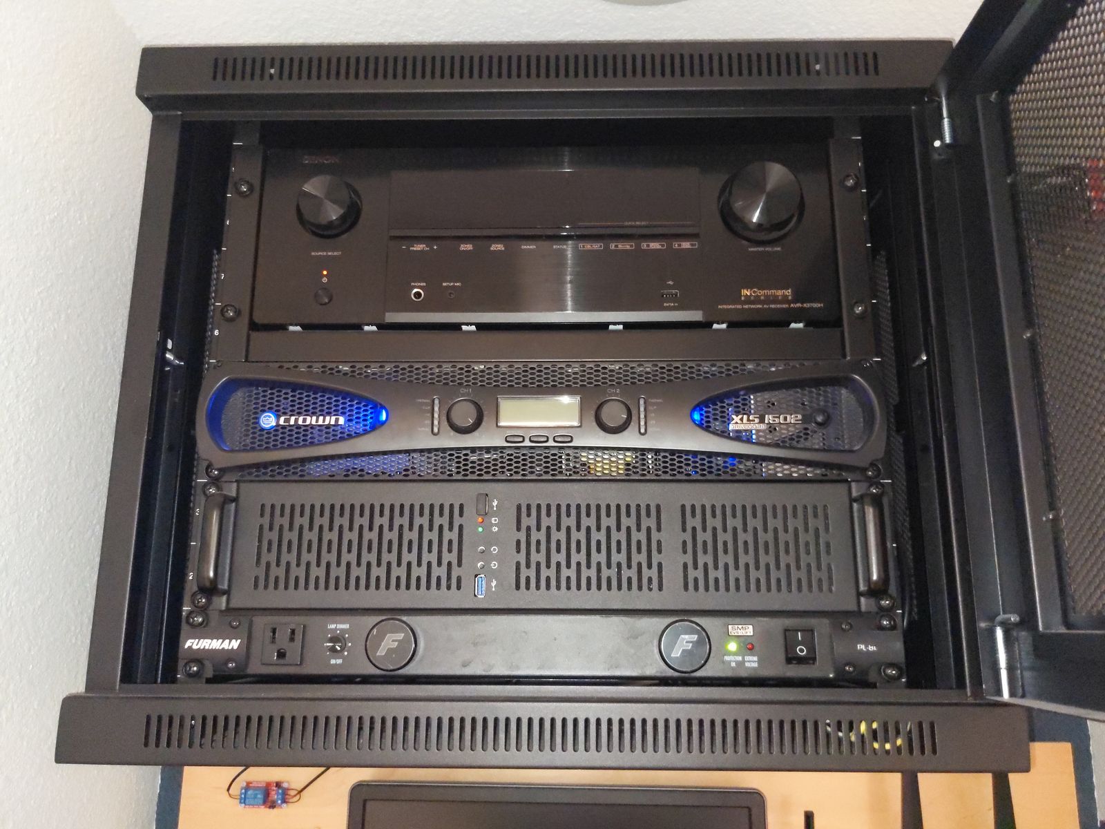

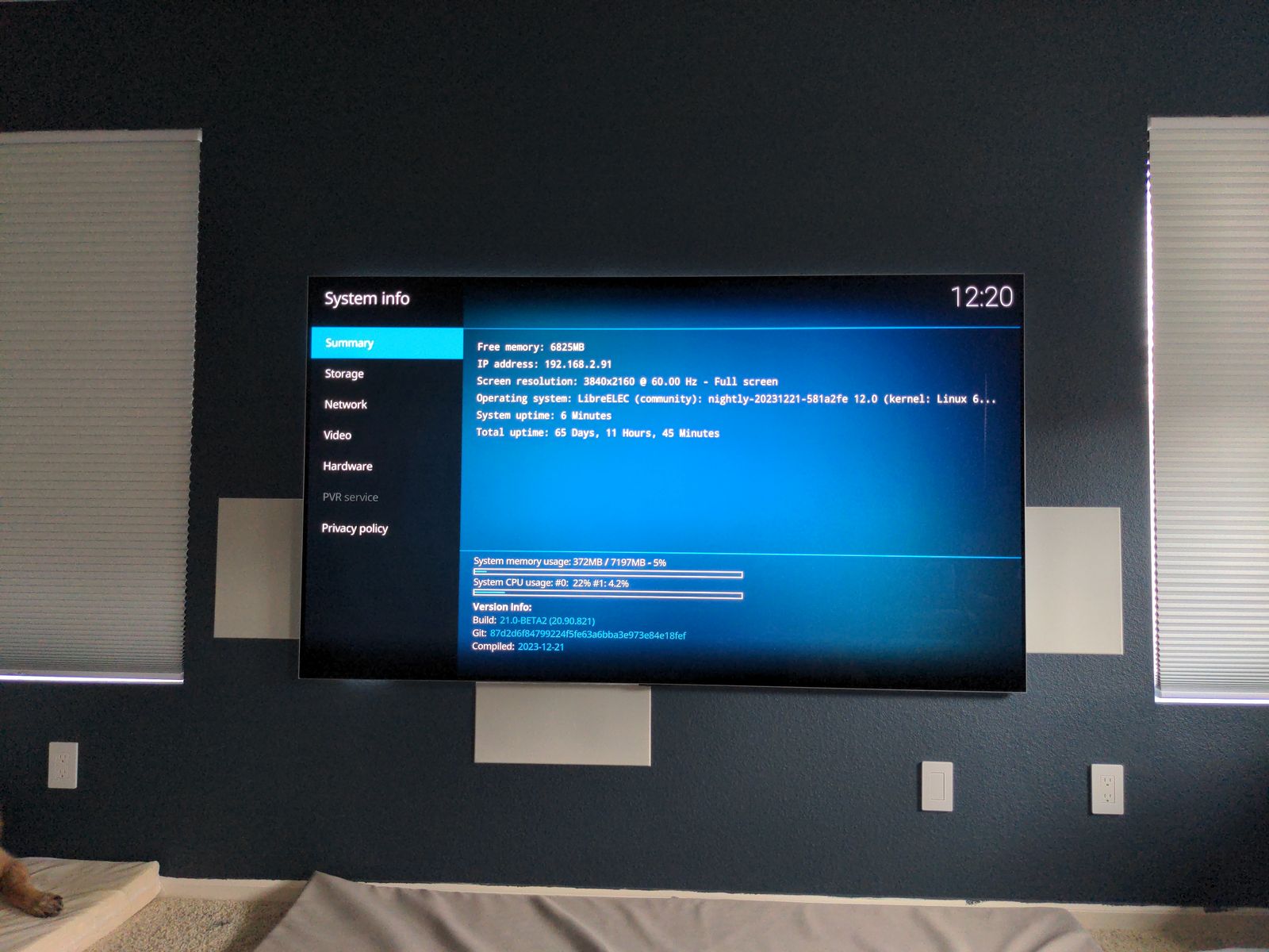

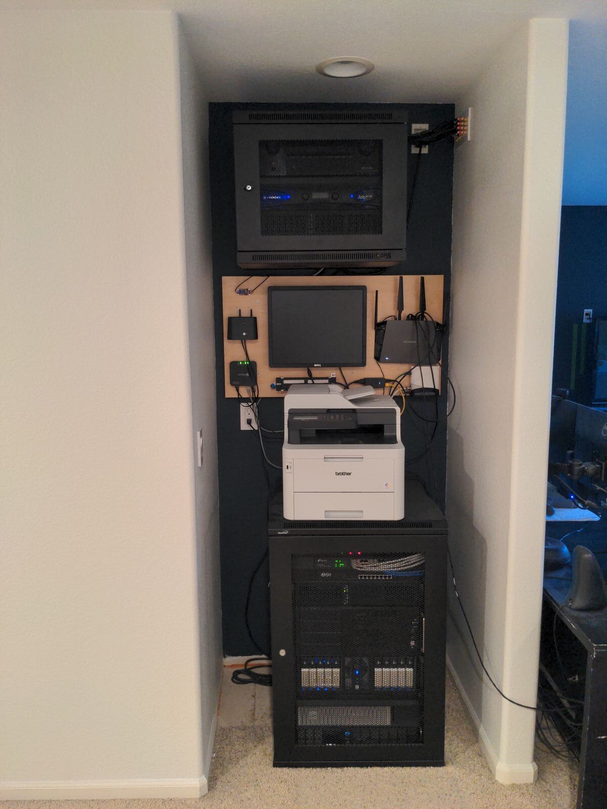

  • Thanks to the developers for this OS! I've been using OE/LE since 2011, and now can finally say I have an endgame system for my family's use case.

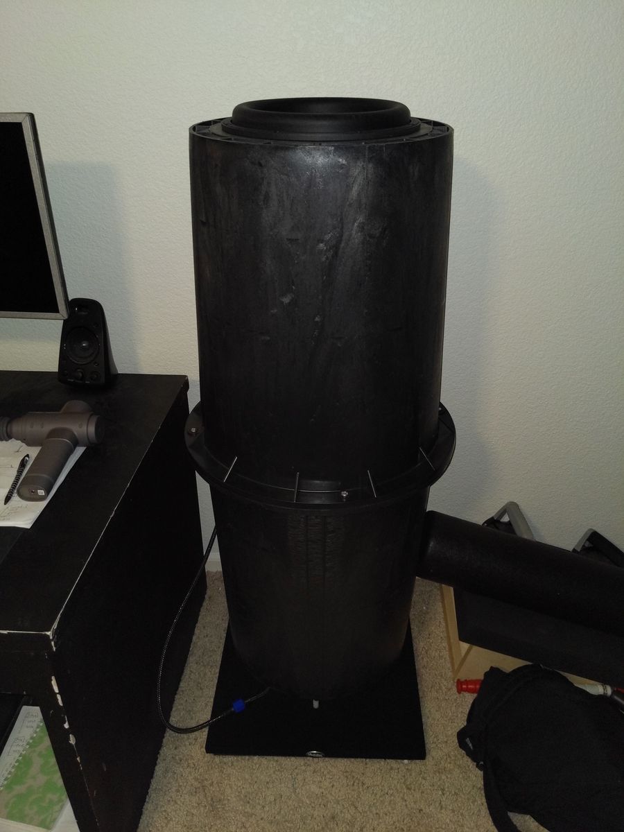

    83" OLED with HDR, 5.1.4 in-wall/ceiling surround sound, dual DIY subwoofers, all controlled with a simple RF (OSMC) remote through CEC (Pulse-Eight Adapter).
