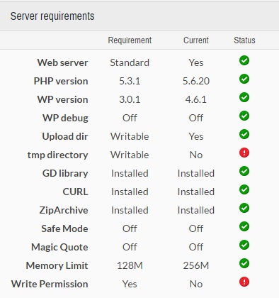

I install lamp addon to s905 device.
I copy wordpress , there already a problem, isnt store the sql settings automatically, but i make it manually with config file.
Try wordpress with with real estate template, with mysql database ,but i cannot upload photos.
I tried with other plugin too.
There is this screenshot.
I watched privileges, but all is 755 at wp-content directory.
I think its enough.
How can i fix it? -
