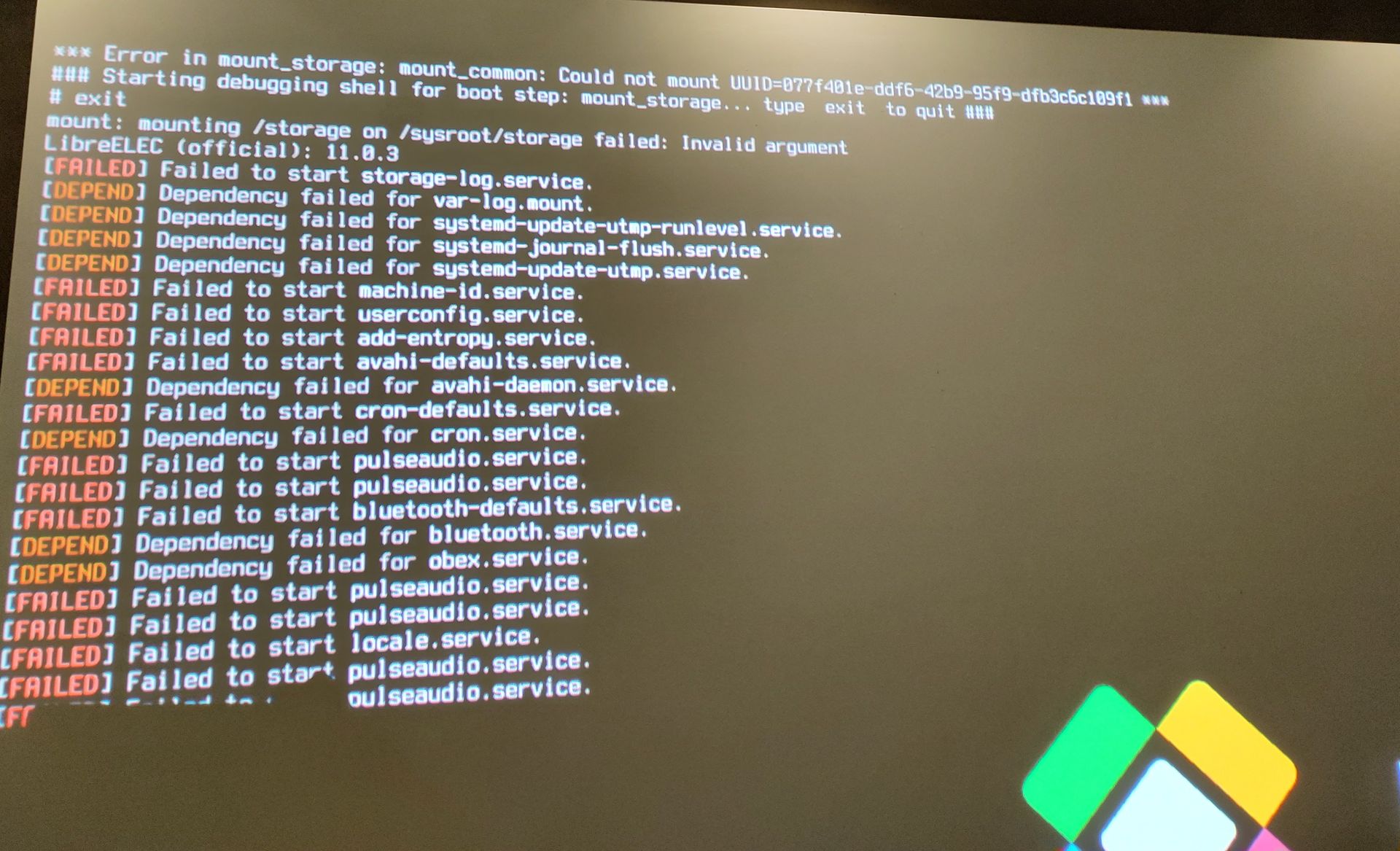

  • So, new SD card - New LibreELEC-RPi4.arm-11.0.3.img
    but im still getting "ERROR IN MOUNT STORAGE" (image attached)
    Any ideas please? Is my Pi4 corrupted?
    It's probably the SD card, there are some SD cards that the RPi just seems to hate. I don't know if updating the EEPROM brings better compatibility, because for me the problem eventually went away.
    What brand/model of card is it? Another thing to try is pop the SD card into another computer, edit the cmdline.txt on the FAT partition and add this at the end of the line (not a new line, without quotes, make sure to add a space and then the text):
    " sdhci.debug_quirks2=4"
    This will disable UHS modes, IIRC. The card will operate slower, but perhaps more reliably. That's what used to work for me on LE10.
