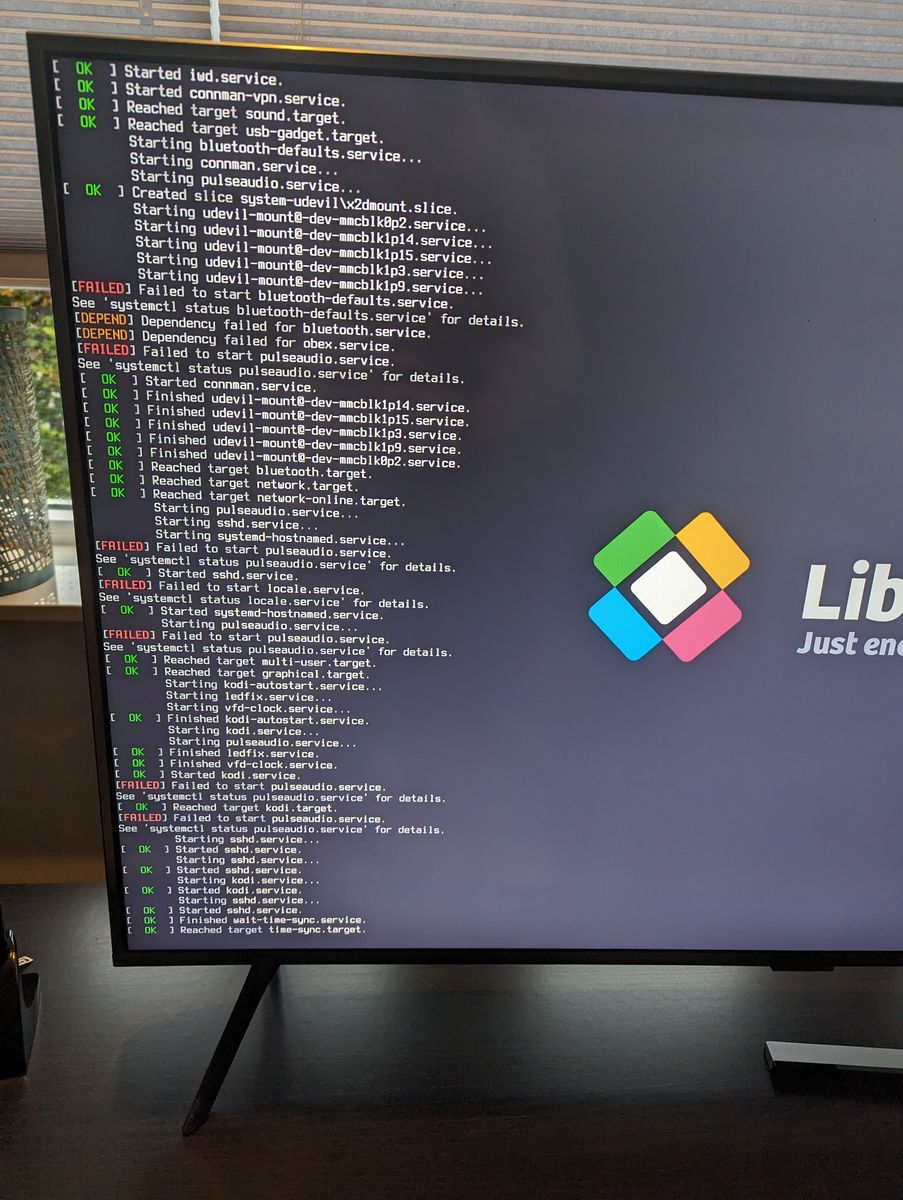

  • I'm trying to use LibreELEC on my Minix Neo U9-H. I've flashed LibreELEC-AMLGLX.arm-11.0.3-box.img.gz onto a MicroSD card, put it into the Minix and held down the power button. It gets stuck on the boot screen with the LibreELEC logo. I've also tried removing the quiet parameter from the boot arguments to see what's going on. It looks like it keeps starting kodi.service, then stopping it again. The process goes like this:
    Started kodi.service
    Job wait-time-sync.service/start running (this runs for a few seconds)
    Stopped kodi.service
    Starting kodi.service
    This goes on in an infinite loop. Could it be a bad MicroSD card or is this likely caused by some other issue?

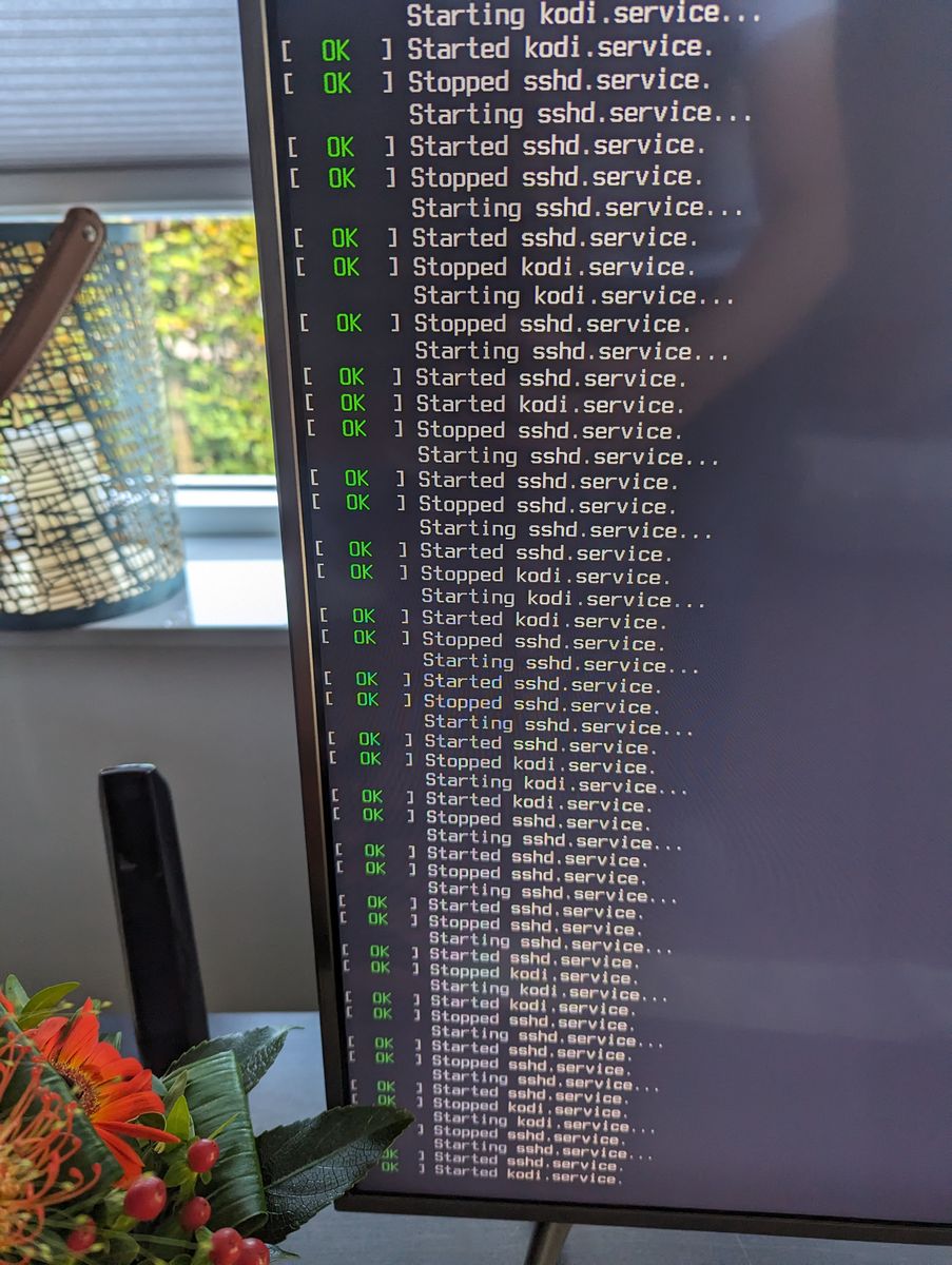

    After adding the ssh parameter, the loop it gets stuck in changes slightly. Aside from kodi.service, it also keeps starting and stopping sshd.service (see image). I tried connecting via SSH, but I couldn't figure out how to do that exactly. I tried running the command ssh [email protected] on my laptop, as I found a page online that said to use that command, but it says it could not resolve the hostname. Am I doing it wrong or is this because of the ssh service being stopped and restarted constantly? In fact, is LibreELEC even connected to the internet at this point? I don't have it wired with ethernet, so it would have to use WiFi, but I obviously haven't been able to set that up in LibreELEC.

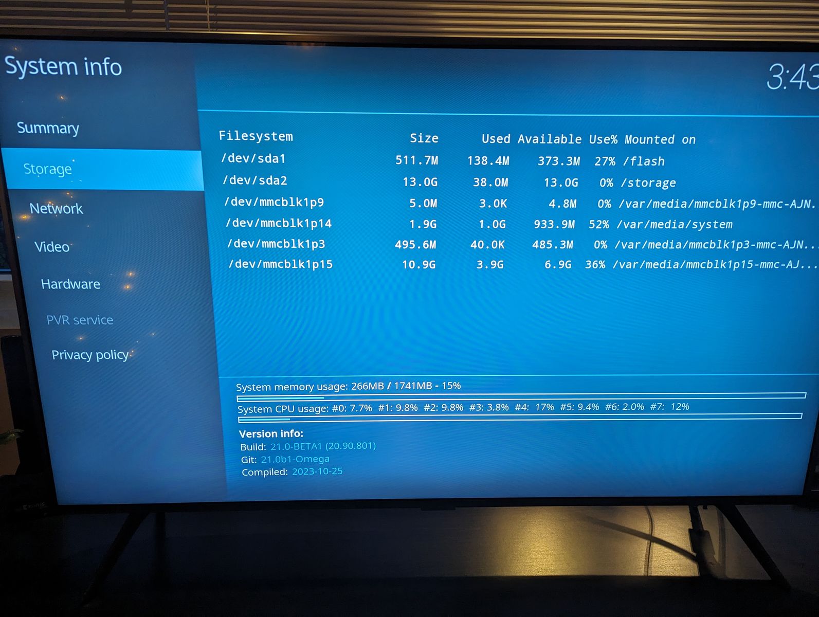

  • I just tried flashing it to a USB flash drive, rather than MicroSD card, and this worked, weirdly enough! Booting was very slow though, due to the USB 2.0 ports on this box.
    So it must have something to do with the way it uses the SD card? Or the SD card itself, but I doubt that, as I tried 2 separate SD cards and both gave the same issue.
  • Not unheard of but a possible faulty SD card reader. After you managed to boot from USB stick have you checked access to the SD card slot with an SD card inserted just for testing purposes.
  • I'm not sure how to properly check this, but I inserted the SD card after booting, then went into System Info->Storage in Kodi, and it doesn't seem to show up there. Should it automatically show up there?

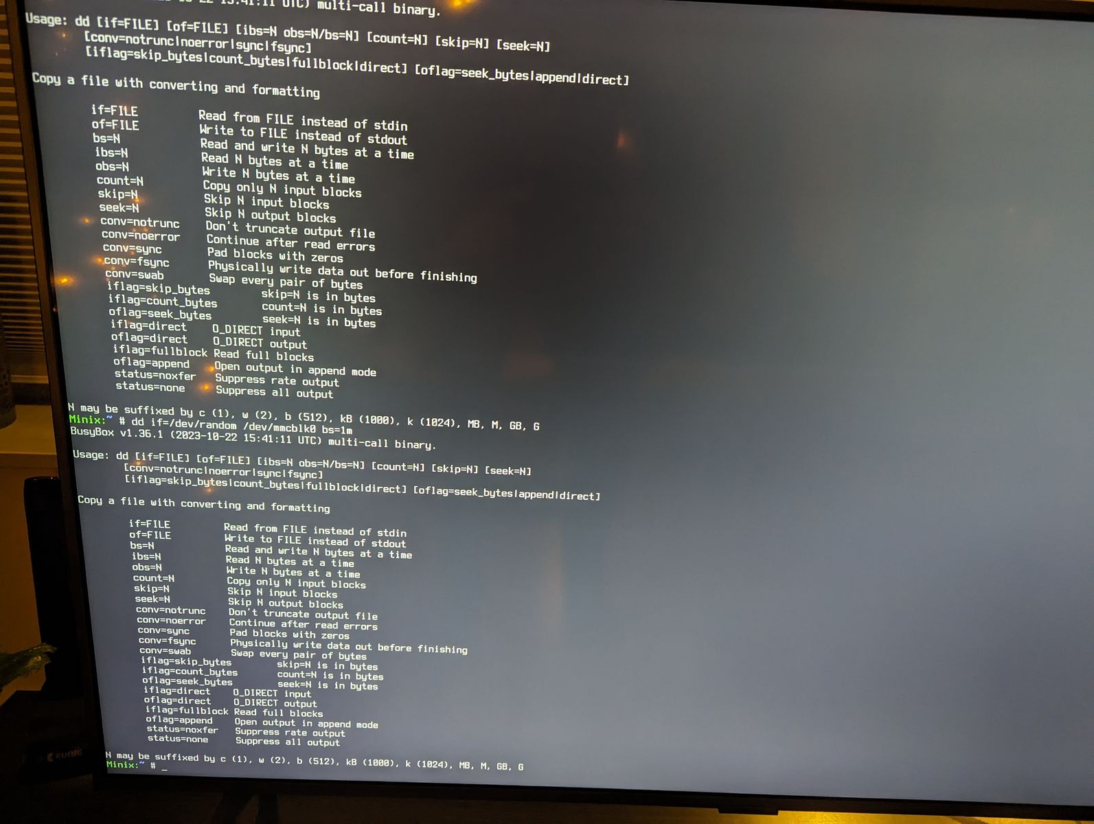

  • The SD card will be /dev/mmcblk0 so as long as that /dev/device exists you can test writing with "dd if=/dev/random /dev/mmcblk0 bs=1m" and the OS will write random data to the entire card. It will take quite a while (larger card size = longer time) but if there are problems with the card (or reader hardware) it'll throw errors and hang/halt/barf on the task. To state the obvious; this will trash whatever data is currently on the card :)
    In Kodi, this is what I see under system Information -> Storage:
    To be clear, this is when booting from USB, and an empty, FAT32 formatted SD card is inserted.
    I also tried running the command you gave in textmode, which gave the following output:
    (I ran the command twice just in case). Seems like the output is just an explanation of how the command works. Does that indicate that it indeed did not find the SD card?
